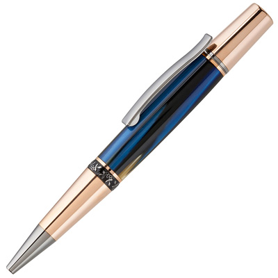

It seems to me that the Sierra and clones all use a 27/64 tube and that people have some problems with blowout turning near the ends of the blank when turning barrels - why not reduce the size of the tube to say 3/8th or 10mm and leave the components the same as now except for smaller press fits adding a little beef to the ends of the barrels without increasing the overall size of the pen? I'm sure the internal components would work

Not sure if it's exacly your line of thinking, but the Artisan Aero at CSUSA uses a 23/64" bit and it is a pretty close look to the Sierra/Wallstreet style.

I'm aware of the Aero but It is smaller - I don't know how much smaller because I've never seen an Aero --- have to get someone to send me one for my collection. It is also more along the lines of the "elegant" type sets. I'm thinking of both standard and elegant types.

I would love to have some styles that have more "meat" on the barrel. Besides the Vista (and the Spring Blossom) there are not many good options for showcasing cast embedded items. Something besides a Sierra clone, though - a Cigar clone would be great!

I think a Sierra could go as small as 9.5mm tubes with no problem and probably to 9mm. with the same size overall. Just more beef on the turned tube.
I do not see why a lot of the kits do not use smaller tubes giving the turner more material left. What is the sense of a large tube when the only thing that goes in it is a rollerball or ball point refill. The smaller tube would make painting the inside of the blank or the tube less critical on acrylic type blanks. The only advantage of the larger tube would be in the casting of tubes with art, watch parts etc.
