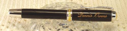

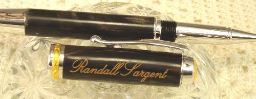

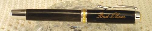

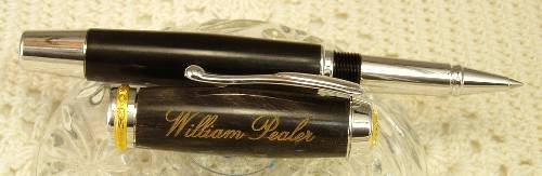

Jr Statesmen rhodium finish. Turned for a church member who gave me one as a gift. The buffalo horn was soaked for 24+ hours before turning & it STINKS.[xx(] Laser Engraving by Ken Nelsen
www.kallenshaanwoods.com
Had taken the pic before caught the fit on the cap. And to think that it was on my personal pen.
Thanks for looking.

Wow, BEAUTIFUL pens Pastor! Don't worry, we won't kid you about that trim ring for TOO long! [;)]

I love the look of buffalo horn. One of these days I will buy some. The engraving stands out but doesnt take away from the pens. Well done.

Beautiful series of pens there. and yes the stuff does reak. I wear a dust mask just so I don't have to smell it. problem is the odor comes in the house with you when you are done. and down the street. and will wake you up at 2a.m. if a stiff breeze kicks up and stirs the dust that fell of your clothes on the way in from the shop. worth every discusting snort though.

A word to the wise,
"Buffalo horn is a natural product" to quote a supplier.
I made one about a year ago, only to open it at a show to find a 1/16" crack down the entire pen. NOW, I use only stabilized buffalo horn.
After enduring the smell and getting a nice finish, the crack really p'ed me off. And, because I can't see worth a darn, I didn't know it was there until I felt the pen.
Just a few words of warning. I HOPE you NEVER need to know this.

They are great pens,Bill is the horn material of the Asian buffalo? I guess the engraving is filled with "gold"... sure wish we had those services available to us up here. Happy turning.........[:)] Cj ......

Actually I think that they are from what is referred to as River Buffalo kept by our Native Americans. I am not sure because the person who wanted the pens made, bought the horn. The engrqaving is natural, no fill was added . Interesting how the engraving worked out. Also Ed is absolutely correct, I now have a small crack in 2 of the pens.[xx(]

pastorbill1952, what the process of soaking the horn blank in the water do? do the smell is bad than the antle? I read, I think on Yahoo penturner that the buffalo horn get crack like ebony, maybe is heat sensitive, is it? BTW very nice pens

Serge, I think the soaking softens the horn so it is less likely to blowout. The instructions say to soak for 12 to 16 hours, but the ones I did that way, blew out. I let these soak for well over 24 hours. The next time I am going to try using CA when I get down to the finish to try to prevent the cracks. This stuff is way to $$ to lose to a crack. Since it was horn I did not use any sealer on them. I thught it made it look too much like plastic. I'll keep posting whne I find out what is happening with the other pens, but even w/ the tiny crack, I really like the feel of the one I carry.

Pastorbill,
Sorry to hear you are cracking up! After my experience, I bought stabilized water buffalo horn from CSUSA. I turned one right away. It is about 6 months old and still beautiful. Strongly recommend the product!!![:D][:D][:D]

Thanks for the info pastorbill1952, is true they not givin them away those blanks lots of $$, i din't know you can find them stabelized, where from ?
