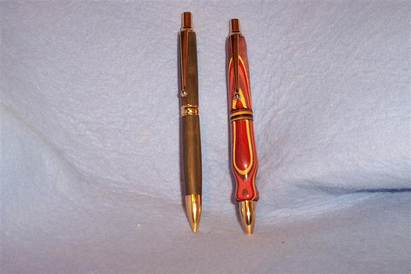

The Power point can be customized by forgoing the supplied tubes and just use an 8 mm tube an 8mm tube cut the appropriate length for the components. Drilling is trick but can be done on a DP with 3&1/8th travel. The other method is to prepare on blank, after milling make a CB with appropriate size hole for decorative CB and mill to correct thickness , glue it on the blank, assemble remaining blank and turned as one piece.
This one has a casing on the top per customer request.
I am not crazy about the nib style on it but that is the only one available.
Here's my shop pencil on the left( made like the catalog pic), the pen on the right is a design made per customers request.Still a power point.
All three pictures posted are power points.

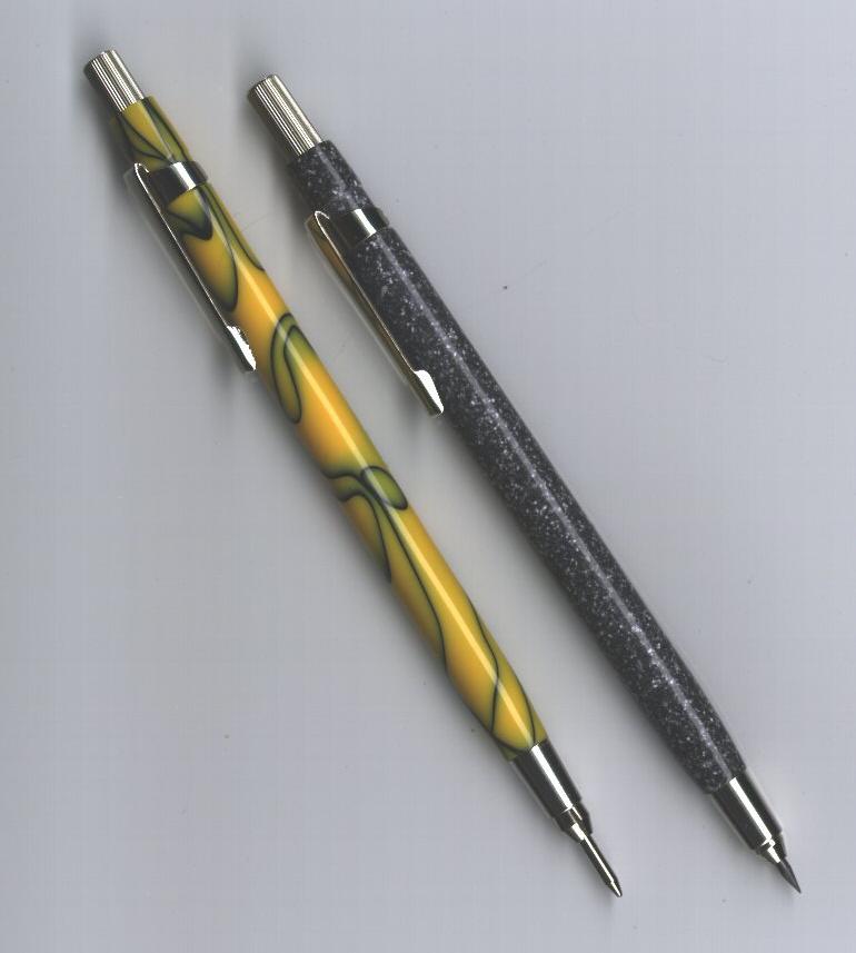

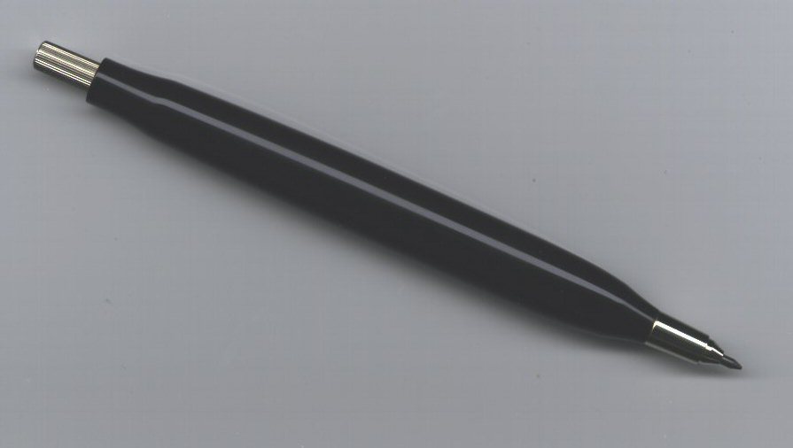

Here is an option. These are 2mm leads based on the Alvin Scott B/2 lead holder. The over all length is 5 1/2 inches with no brass tubes at all.
<br />
<br />
Chuck they look great, In th esecond picture, is the one on
the right acrylic or corian?
I wouldn't have much concerns about acrylic, stable, but if corian I would be concerned with it cracking if dropped on a hard surface, but they look great!
For sharpening that fat lead, take a trick from the old carpenters. Way back they used a marking knife to make lines. That was later replaced by the carpenters pencil. Those rectangular shaped things with the rectangular lead in them.
The proper way to sharpen a carpenters pencil is to make the lead look like a chisel point. The lead it a real one is very hard and will cut a line in the wood like a knife. You expose the lead with a pocket knife and then sharpen it with sandpaper, or if you are skilled with the pocket knife you shape the point with it.
Forget the lead sharpener that is in the cap of the pencil and sharpen the lead with a small piece of sandpaper on a flat surface. Just rub one flat on one side of the pencil lead, so the end looks like a chisel or lathe turning tool. You hold the pointed side against a straight edge and it will cut a fine line accurately.
The one on the right is Corian. The first one is Plexiglas, three laminations of 1/4 inch Plexi.
Chuckie

Go to http://alvinco.com/dealerloc.asp and put in your zip. It is a good idea to call the dealer first since I went to two stores, one had them and one did not. Ask for Alvin "Scott B/2".
This is not a cut and paste kit. You will need to cut out the guts from the original pencil and the blank requires step drilling I used 17/64ths and 13/64ths drills only because that is what I had on hand. It is not real compicated though.
