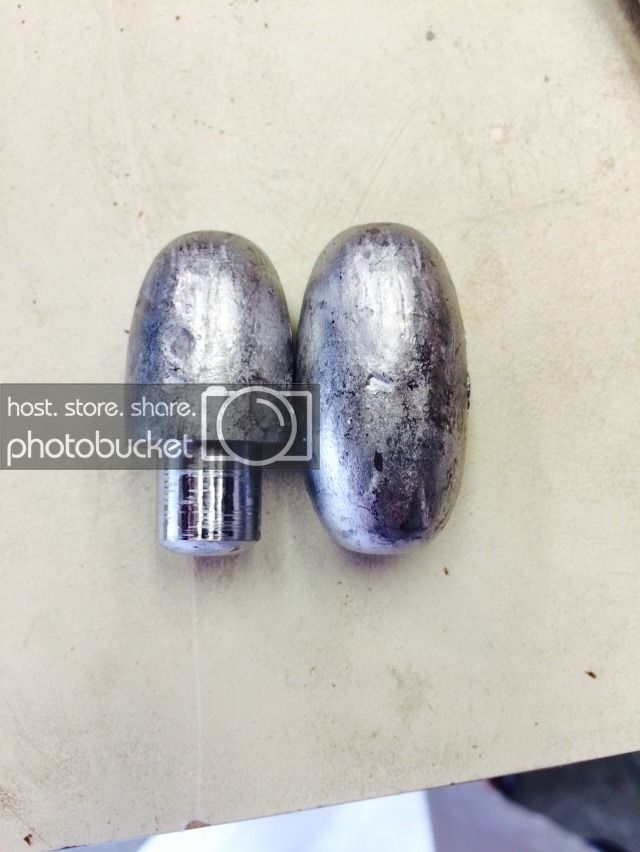

Here is the before and after of the sinker.

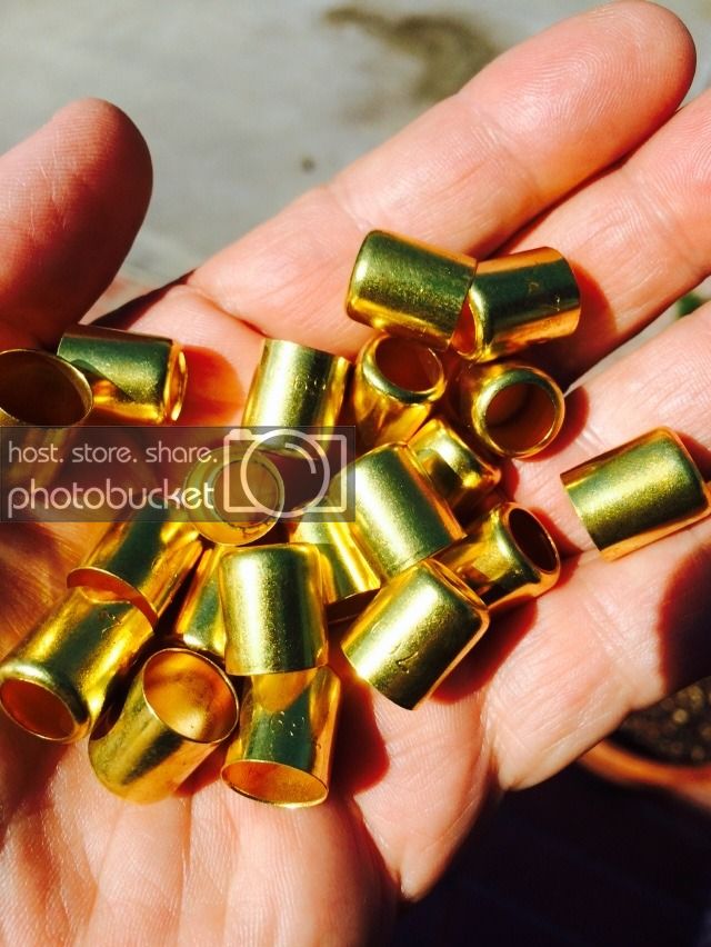

These are brass ferrules for the tail end.
I turned the sinker between centers and used a carbide pen tool with a flat surface.

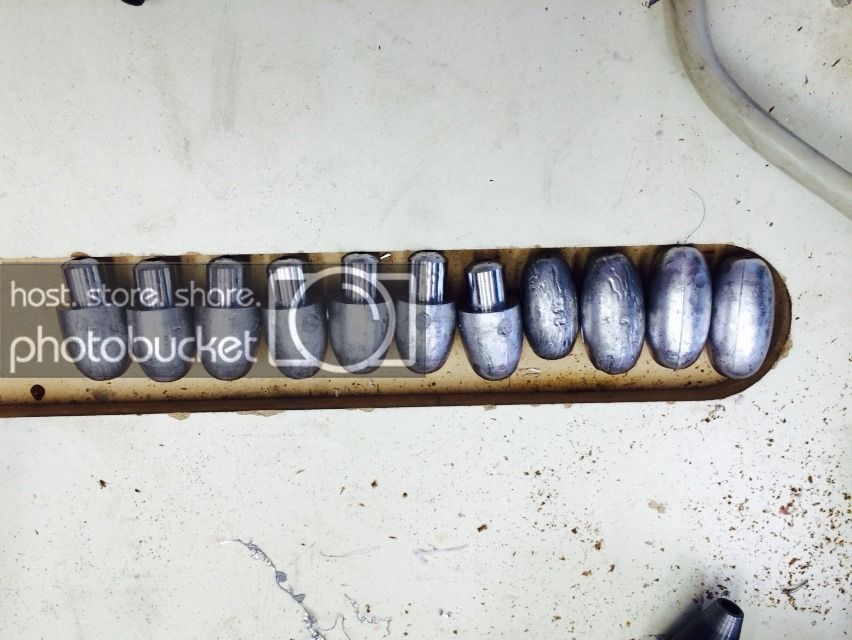

Today's work (last one not turned) and all have yet to get BLO/CA finish.

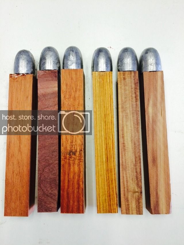

I have tried drilling both the recess for the head first and the drill out the hook recess using a pens plus chuck on my nova chuck. This method did not center the tail end well. Then I tried just drill the head, seat it with epoxy, turned the head / blank and drill the hook recess last. I guess I am still not happy. The turned head is not a great object to turn smoothly with the tail unsupported to drill it.

This is how I would do a simple plug.
1. Drill the entire length of your blank.
2. Use a step drill bit to countersink the head
3. Turn the blank to shape.
4. Drill out the head for the line.
5. Turn the head to shape and fit tight into the plug.
6. Epoxy the head into the plug.
7. Apply your finish (I like envirotex but there are other choices). You just need it as waterproof as possible. The first fish is going to tear up any pretty artwork (if you wanted to paint) and the clear finish.
8. Decide on your leader material and strength. This is going to be the most upfront cost in your project. I like at a min 130lb (and it will be based off your finished lure size and target fish) but expect $60+ for a spool. On some lures we use wire, it costs a lot less and much stronger.
9. Attach a quality sharp hook to the line, run the line from the bottom to the top, pull tight and finish with the knot of your choice.
The wood block will drill out using a set up like Les Elm shows for drilling Antler pieces. Drill first and use the drilled hole in the wood to be the centers. Old concept of making the whole thing fit around the hole.

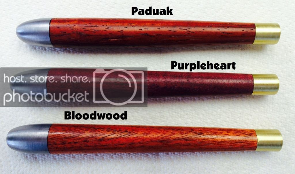

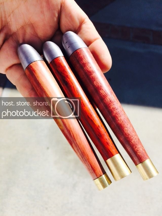

I use these steps to make one
Cuts wood blanks square
Drill recess for head on lathe ( careful to center on blank )
Drill entire length from other end for hook/line on lathe ( careful to center on blank )
Turn between centers to make the tenon for the brass ferrule
Turn lead heads to make even round end for insertion into wood
Epoxy head and ferrule
Turn wood and head between centers
Sand
Finish
Rig for fishing with hook (I swage on 100# mono)
