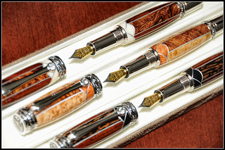

It can be a pain in the butt; however, if you take your time and use sharp tools it makes things a lot easier. I wrote a tutorial that may help here ( http://www.penturners.org/forum/f56/steps-i-use-scalloping-*long*-89931/ ) The missing picture on the opening page can be found on page 3 of the link.

Awesome work Tim. I have to confess that it was seeing these pens on your Flickr page several weeks ago that inspired me to try it.
Ken
Ken,
I'm glad to hear that my work still inspires others. I can't wait to see what you come up with.
