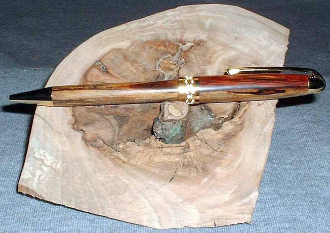

I think the Streamline which is a variable to the slimline would be nice. Here is one from Bocote that I did recently. Good luck
Brian

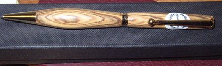

Here is a photo of Bethlehem Olive Wood slimline I completed today. I almost never turn B2B. As you see, there is lots of variation possible in this basic kit. At the widest point, the pen is about 1/2'' diameter. Most of my customers like the feel of this shape and tell me the size is about right. Obviously, you could make this smaller as needed to fit in your friend's pen case.
Cheers!
Doc Ron
