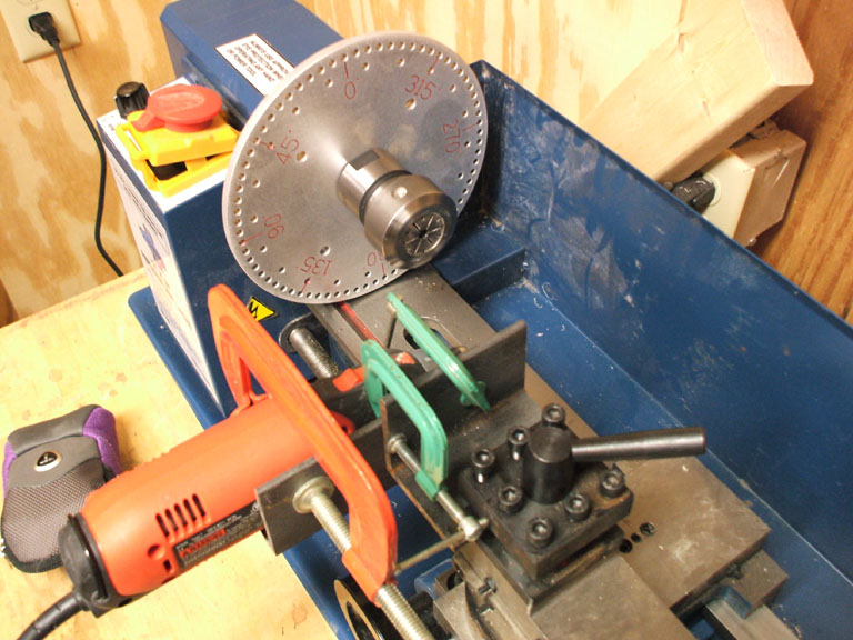

I've done it with a dremel like tool clamped to a couple of pieces of angle iron and an index wheel.
attachment.php

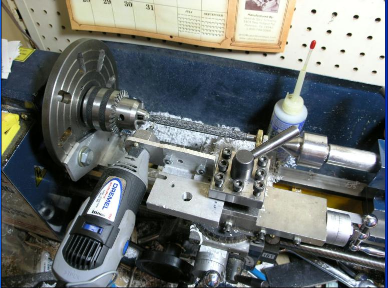

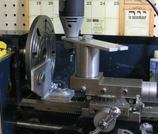

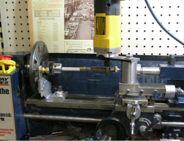

You should be able to come up with something that will work. Here are a couple of idea photos.
