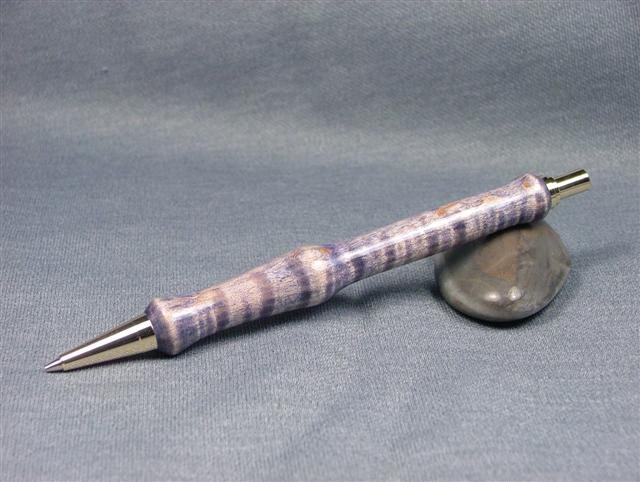

You could try marker instead of food colouring or dye. This is a blue one I did using a Sharpie. Coloured it solid with a navy blue marker then lightly sanded to reveal some of the grain and curl again then went through the final sanding and CA application.

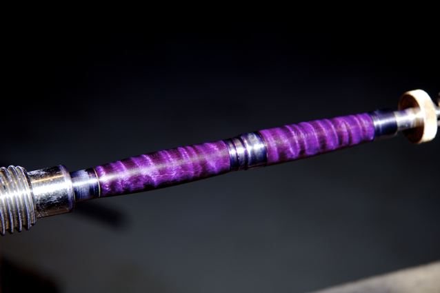

Here is a shot of what he likes. It will be ingraved and filled with gold and on a gold-ti kit.
Ron, if your blanks are that color I would LOVE to get one or two from you (and I hope many more in the future).
