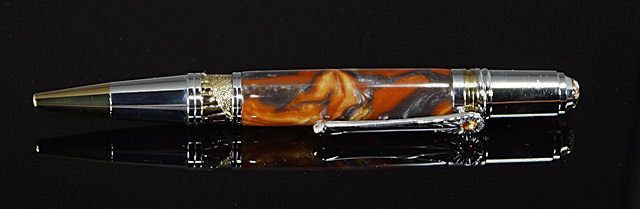

Photo was taken with a Canon EOS XSi on macro, fully auto.

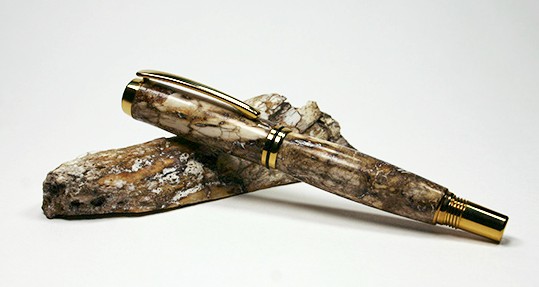

I copied your first photo and touched it up using a MS photo shop, is this what you want...Its a good photo of a great looking pen.
Yeah, that's very nice. I have photoshop elements, and have taken a 2 year online course learning to use it, but I really want to get away from photoshopping my pens.
