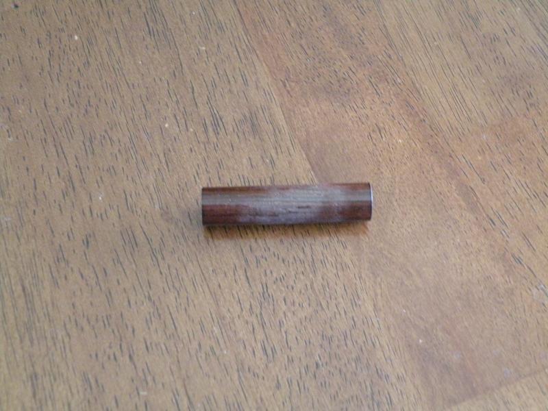

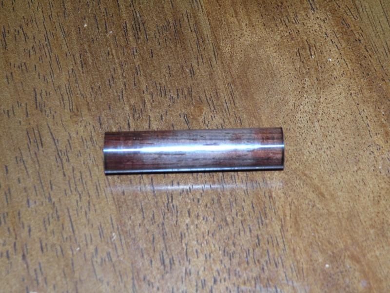

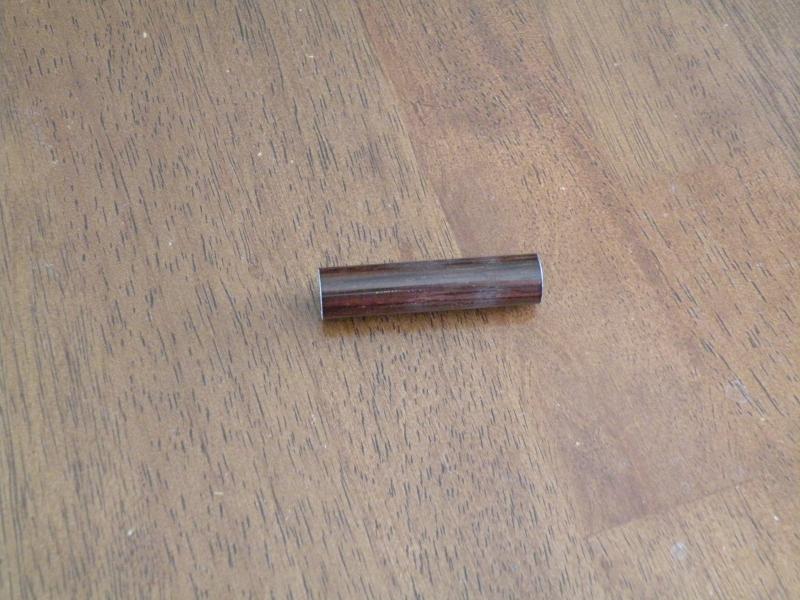

Hello,
I was hoping someone could tell me why the CA finish on the attached blank turned out the way it did. Some of it looks really nice and clear/dark other spots look milky/cloudy. I am new at the CA finish and until now have had good luck. I say luck because I am not sure exactly what I am doing applying CA as a finish.
The cloudy spot don't show up until I am using the mirco mesh to sand. I also noticed it when I applied the "one step platic polish" to the CA finish, which I had done before.
Thanks for any tips/help. By the way the wood used here is Cocobolo.
Ernie

Others will probably have better answers for you but the way I see it, blame the wood. Cocobolo has oils in the wood that interfere with a good CA finish. Been there, done that. Try wiping the wood down real good with Denatured Alcohol or acetone before the CA. Just make sure you give it plenty of time to dry before the CA. Bocote and zircote along with others will give you the same problems. Good luck.
There are several things that might be happening.
It looks to me as you are not applying enough ca and so it is all getting sanded off as you go through the mm.
If its not that then it might be because cocobolo is a very oily wood and so the clouds would be moisture from the oil or from other water that has built up under the ca.
Hope the info helps. I often had trouble with the first issue.
Michael
I would suggest that it is a problem because of the oils in the cocobolo. Did you wipe the blank with mineral spirits or something similar before applying the CA? I'm no expert on this so it is just a suggestion.
Michael
Cocobolo is an oily wood. Oils will actually disolve CA after long exposure. In this case the oils prevent the CA from sticking to the wood. One suggestion has been to tub the blank with acetone or denatured alcohol and allow to dry, just before applying CA. I like the DA better than Acetone, as acetone can discolor some woods. Sand this finish off and give it another go!
Adam
You have sanded through the CA to the bare wood. It did not show up until you started sanding because the sanding dust will stick to the bare wood but not the parts that still have some CA.
It is true that CA is very oily, which can cause the finish to lift in some areas, giving it a cloudy look in those areas. However, I do not believe that is not the case here. Hit those dull areas with some sandpaper. Is the dust white or does it have a reddish brown (cocobolo colored) tint? If it is white, then those areas are still covered with CA and it has just lifted off the surface. If it is colored, then you have sanded through to the bare wood.
I have never wiped the oils of any wood I turned. And have not had any spots show up since I quit used the CA/BLO method. Part of your problem I think is sanding as mentioned before and another part may be to much activator being sprayed on? I spray from about 6-8 inches and spray very lightly - just a spritz! Ok so now what is a spritz? A tiny spray? I also put on at 6-8 coats before I touch sandpaper.
+1 on cocobolo oils causing the problem. A friend of mine places his cocobolo (and any other oily woods) into a bottle filled with denatured alcohol. After about 30 minutes, most of the oils have come out of the wood. Now, sometimes losing the resin and oils in the wood will affect the grain color in the wood. In those cases, wiping with DNA will remove oils and resins, but not enough to change the color of the grain. Cocobolo is one of the woods where turners get improved results through personal experience.
I haven't had any problems applying ca to my cocobolo blanks after sanding and I only wipe them with a paper towel. Are you sure the ca your using is good, or maybe your using to much activator like keithbyrd said.

I definately think you sanded through the CA. The bushing kept you from sanding too much on the ends which is why the middle looks worse. Sand them down to bare wood and recoat; 2 coats thin and at least 5 coats medium. Then when you sand, knock the high spots down with 0000 steel wool, than very lightly with 400, 600 and I use EEE paste after. Depending on how gloss I want I use plastic buffers rouge after.

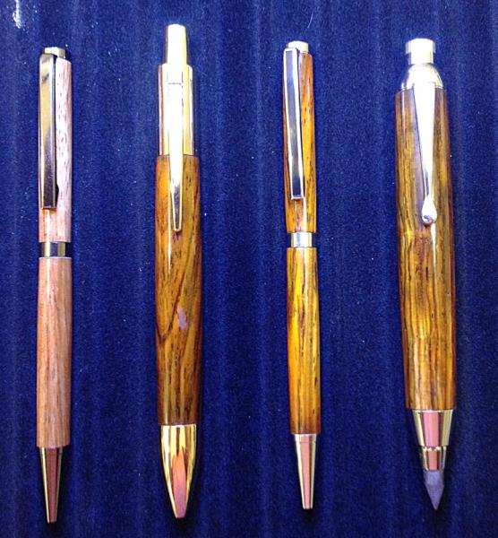

I've been wiping mine down with Isopropyl alcohol (just because I had some handy) before the CA applications and that has worked pretty well. I'm new at this but I've had good luck with Cocobolo so far.
In this picture the three pens on the right are Cocobolo.
(Notice the first Cocobolo pen has a cloudy spot - looks a bit purple in the picture. Looks similar to yours. I think the problem was that I did a messy CA finish, sanded it off, then re-did it - a bit of the old finish was still there. I didn't notice it until after final polishing of course.)
