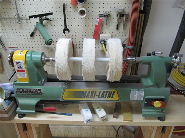

While I have the 3 wheel Beall Buffing System, I took George's advice with respect to his thread and built another 3 wheeler. I have never used my Beall again.
attachment.php
This is my permanent buffing station using Formax Buffing Compound http://www.formaxmfg.com/plastic-buffing-wheel-bar-compounds sold by my Caswell dealer. I use the Plastic-Glo Ultra-fine Dry (515-6163) first, and then the Plastic Compound Extra-Fine (515-6165) next. All my pens both wood & acrylics, are buffed using this system. I only dry sand to 600 grit both across and with the grain. For the acrylics I may do an extra sanding with 0000 steel wool. Then it's on to the buffer. You can see the wax sticks on the bench, I also apply them to my CA finished wood pens.
All in all I am very pleased with this system.
