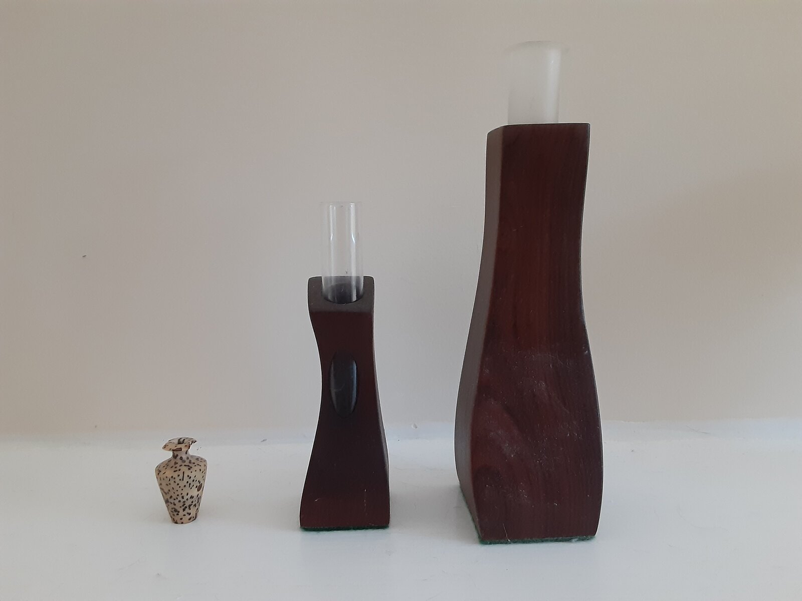

I used to make/sell wood vases with glass inserts that had a flared top. I did not glue the inserts into the wood turning, but made it a snug fit with a small counter bore so the glass would not be visible. CSUSA sells a variety of inserts.
I used test tubes. Made several "bud vases". Frosted with sandblaster.

I have used both plastic and glass the advantage of the plastic you can cut them and turn so they fit into the Vase and are undectable. Polyurethane varnish can be also be used poured in and rolled around use several coates. But inserts are easier.
Otherwise its artificial flower's.
Good luck with it which ever way you go.
