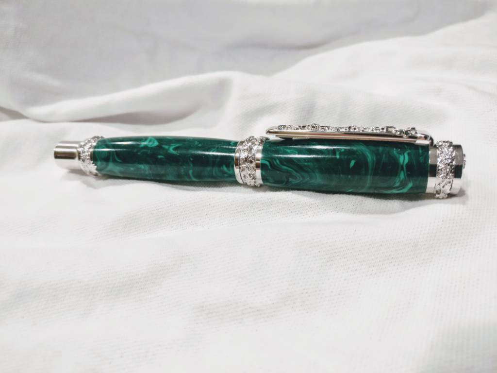

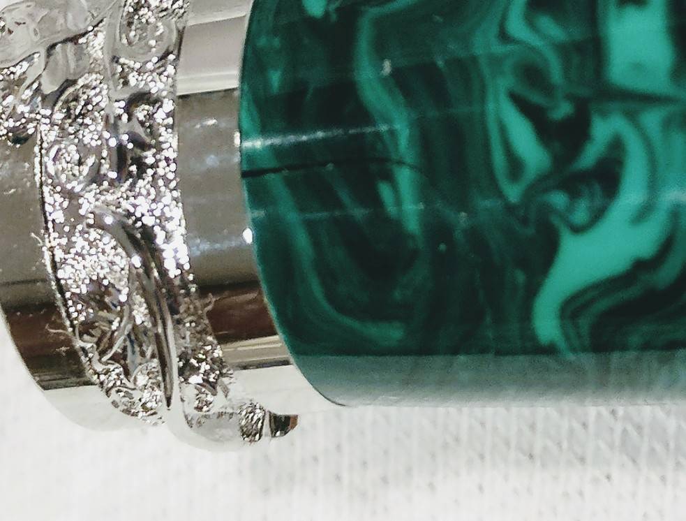

So I recently grabbed this Jr. Palace vines kit and the beautiful trustone blank from members here. They looked like they belonged together so yesterday I set to making it happen. Drilled perfectly, turned decently, and mostly assembled ok. Pressed the clip on the cap last and that huge clip did not want to allow for good alignment... Got it where I thought it was ok and then *crack*. Four letter words were used, copiously.
So now I've got a crack running vertically next to the clip that cuts sideways after a bit. My thinking is I try to get the clip piece off, then attempt to break the piece off clean and glue it back. I suppose I could try to get some CA glue into the crack but this may be cleaner. Ugh
Is it really worth saving? The blank can be replaced. Disassemble and start over. This is not what you wanted to hear so you can move on to the next suggestion. Its all good. The crack will always be there. Pen barrels that break into pieces while on the lathe or during assembly are not jigsaw puzzles but trash. Good luck. This has happened to most all of us.

Bummer! Without disassembling the pen, the only thing I can think of is medium or thick CA. If you have any scraps of the blank left, you could make some "sawdust" from them and add that to the CA to make sure that the brass tube does not show through. It looks like there may have been a bit of glue inside the tube or perhaps the tube had been bent oval just a bit prior to gluing it into the blank. Good luck.

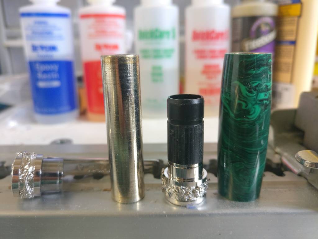

I dunno about trash... It's not ideal but I think I've salvaged worse. It's really the disassembly that scares me since the plastic pieces won't really do well in the effort. The clip piece I should be able to get out safely... In theory.
For a proper repair the cap has to be taken apart and repaired on the lathe. CA will get on the surface of the cap and will need to be sanded and refinished. It is almost impossible to fill the crack with CA (with or without some type of filler) and not get CA where you do not want it. Just saying. There are just no shortcuts. Again, not what you want to hear.

If you plan to disassemble, you could add contrast bands. It could either be a solid band or a thin piece of aluminum and another piece of the blank to give it a silver colored ring.
After pressing many fittings together in my years (not only pens), this is what I do to prevent the cracks in pens.
I make a dowel and wrap with sandpaper. Put it on the lathe and sand the interior of the drilled hole. This slightly enlarges the whole to give room for expansion of the tube when the parts are pressed in.
I use epoxy to adhere the tube. It has some flexibility as compared to CA and will allow some give when the parts are pressed in.
I also use a round file to clean the interior of the tube and give it a slight taper at the opening. The file will remove any epoxy that might have gotten inside the tube. Even a very thin film will cause resistance. It also removes the high spots and makes a more uniform surface. The taper helps with alignment and removes the hard edge that can catch the part being inserted.
Lastly, I spray a little silicone on a towel and wipe the interior of the tube for some lubrication.
This is what I've used and it's worked well for myself. It might seem like a lot of extra work, but when compared to the time it takes to turn and finish the barrels, it was worth it to me to reduce the possibility of loosing a blank. Especially an expensive or special blank that is irreplaceable.

On reassembly after repair, can the clip be positioned so as to cover and hide the majority of the repaired crack ? . Just a thought, because with your blank on that ornate pen kit, I would think that an oops band would really look out of place and appear to be an obvious "kludge". . Just my thoughts.

Whew, you guys are busting my chops on the tube. I assure you, the brass was clean! I'm just a bone head and rather than back off and re-align I forced the issue when the gigantic clip was being difficult.
Mal, you might have a point... I was actually going to look at segmenting the top and bottom of the cap though so it wasn't just a random oops band. Even have some left over trustone that could work if I was strategic about how I did it.
What'll likely happen is I'll buy a new blank, some new tubes, and give it another go. First time using this particular kit and wasn't quite in the right frame of mind to be patient with the flip trying to force the whole thing sideways.
