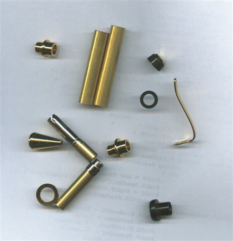

I have a bag full of these kits that I bought some time ago that I'm trying to identify. I think it's a cigar pen, but I'm not sure and I need to find the directions for turning and assembling. I've attached a scan of the parts, any ideas? And do you have the Instruction sheet if you know what it is?
Thanks, Don

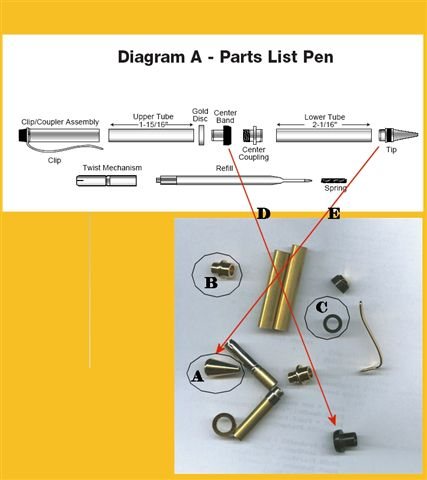

I thought it was this kit at first too, but there is some differences that gave me pause.... looking at the attached picture, is the writing nib a composite of parts A,B, and C?
The Center band in the diabram appears to be black and chrome, suggesting a composite of the two material as oppossed to the piece I have that is completely black.

Originally posted by cteaglesc
<br />Here's the link toPSI's cigar, they're all the same.
Watch it when you put the bushings on
From the nib end it goes
Smallest ,second largest, largest, second smallest.(at the finial)
I know I've put them on wrong at least once.
http://www.pennstateind.com/library/PKBIG&PCL.pdf
Tell you what, why don't you just send them to me and I will send you a nicely labelled slimline kit complete with directions. [;)]
Looks like the ciagr kit to me.
Thanks, but I think I've got the 411 on these kits now. Maybe you should change your name to Kitscavenger [^]
BTW, I found this page off of Pikes Peak woodturners site that shows a really good picture of all the parts and instructions. Just what I needed.
http://www.penturners.org/content/CigarPenInstructions.pdf
