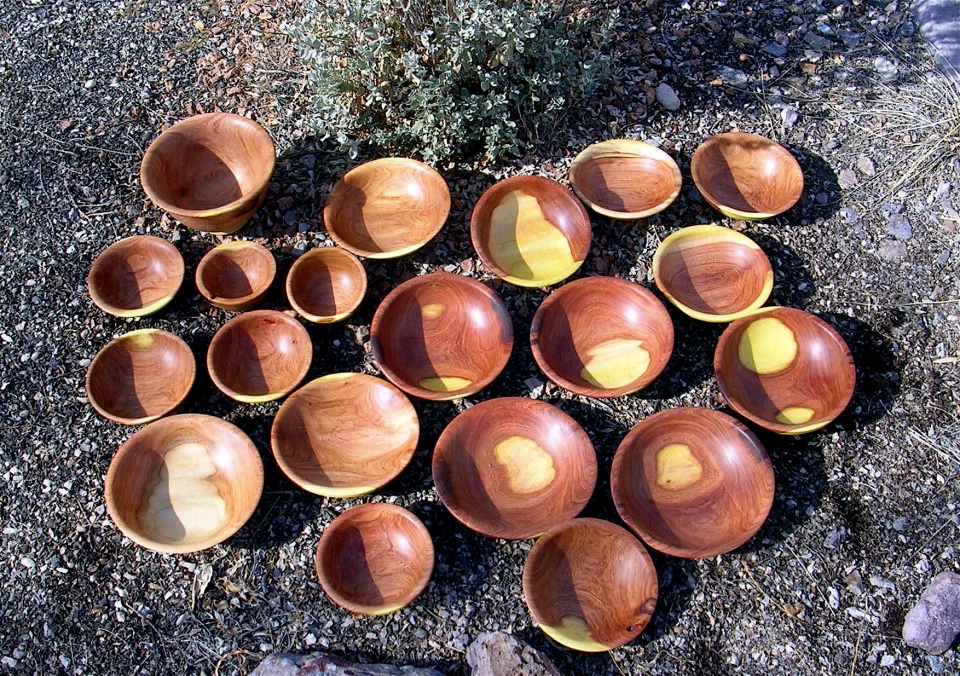

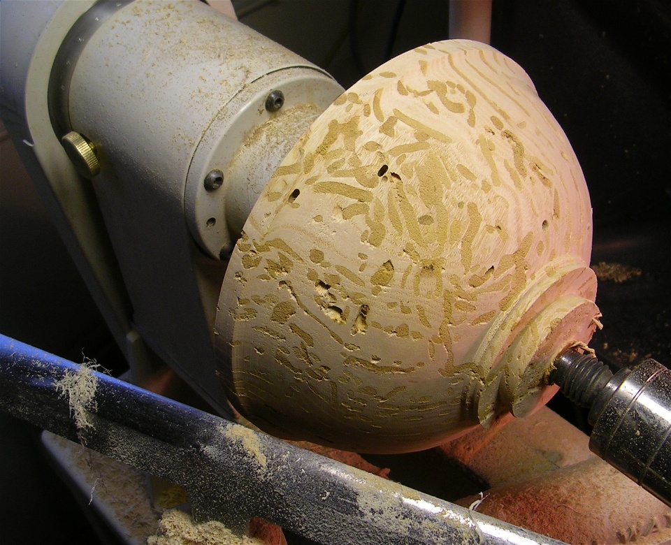

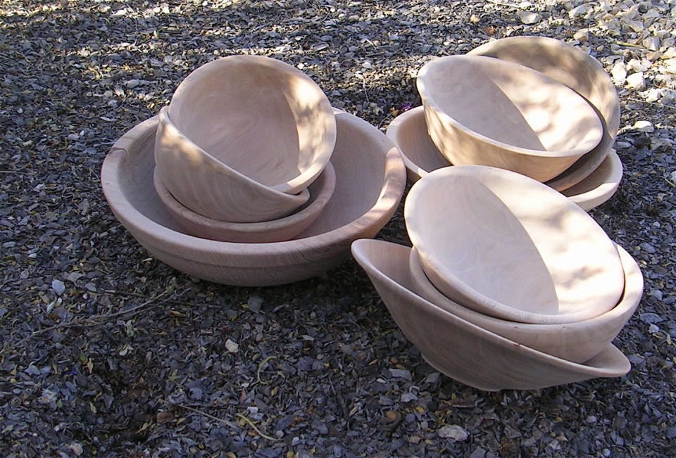

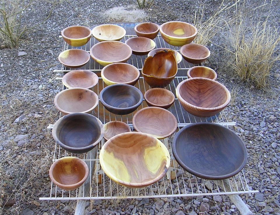

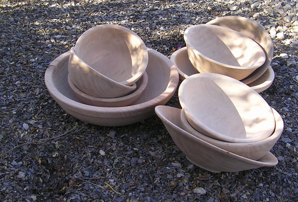

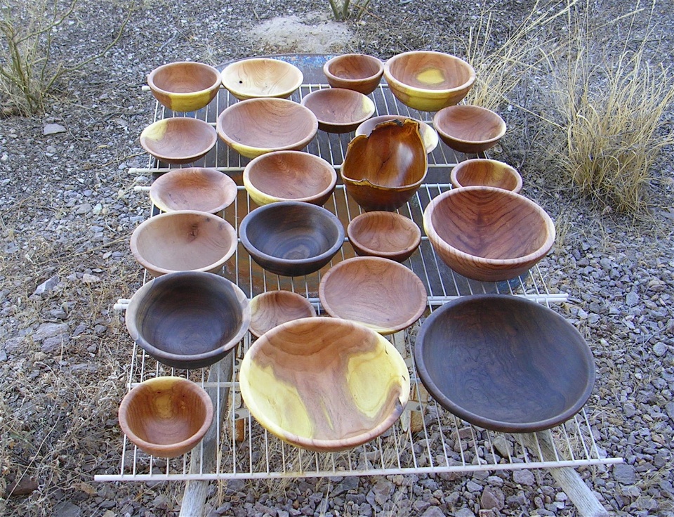

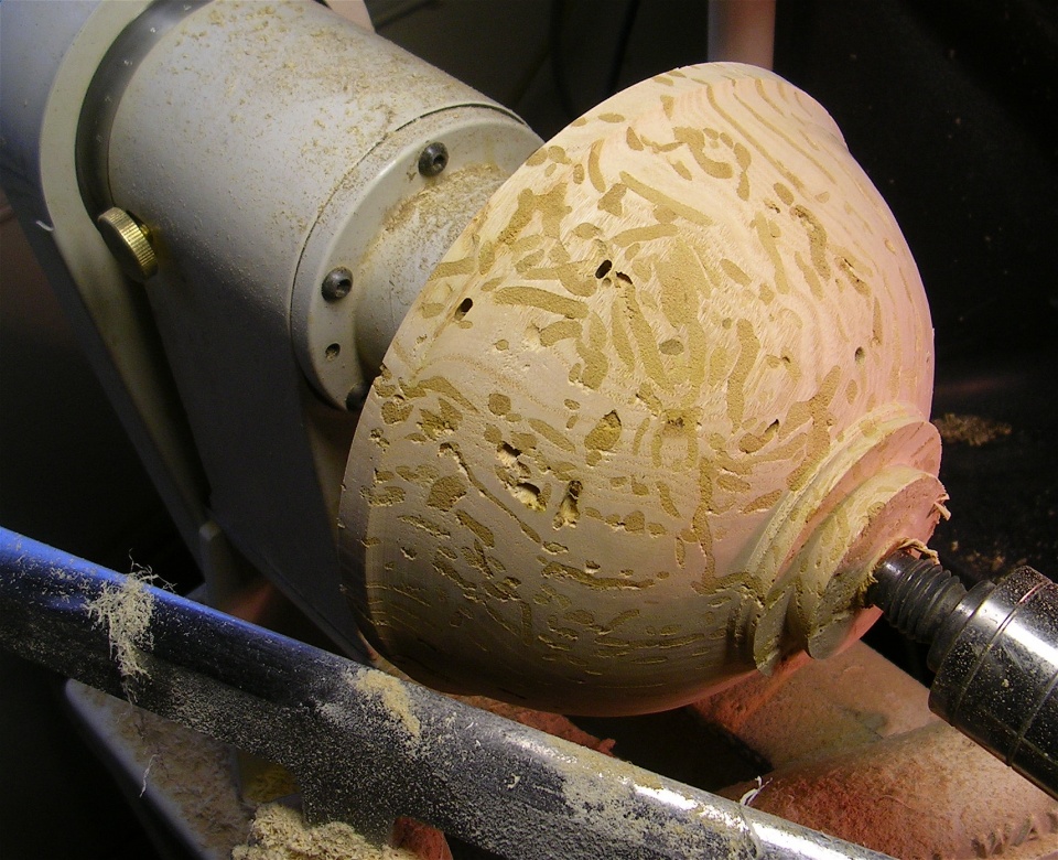

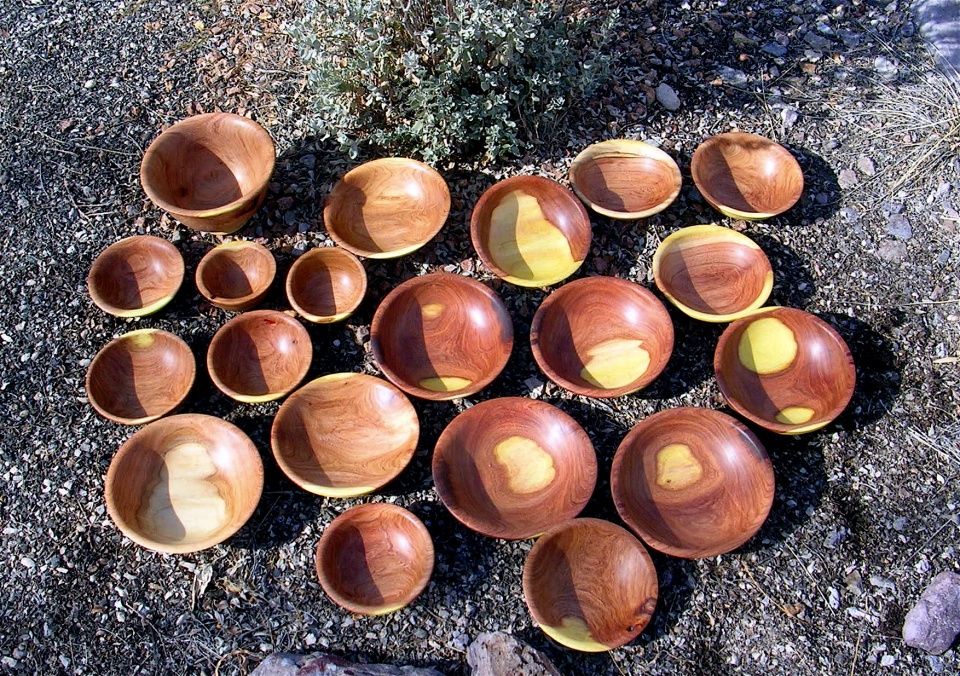

I think that the beads of courage box could be a little smaller. It sounds like your belt might be slightly slipping. I have a small Rikon and I can turn up to a 9" bowl with no problem. I can turn them on my little jet also
Ed,
I have turned a quite a few bowls in the past and a several things will help you get faster results. ( others have already mentioned some )
Rough cutting a circular blank saves frustration for sure.
Driving the blank with a screw chuck or faceplate will avoid the slippage of using a spur drive.
Starting from the tail-stock towards the headstock to knock off material for your rough shape gets the lathe in balance quickly. It also will give you room for the banjo.
The faster you can turn initially with little vibration the better. You will get better cutting action from your tool .
Any Mike Mahoney videos you can view on-line will help.
