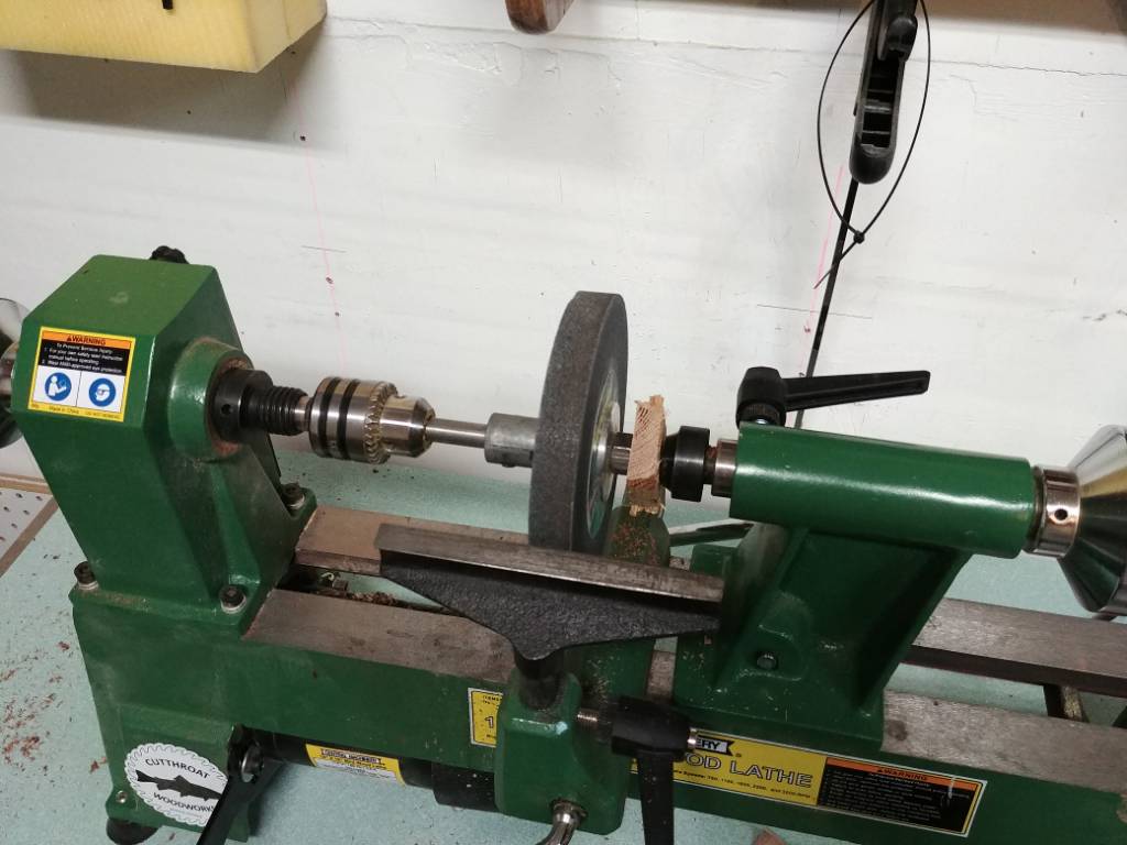

I'll post a picture of my sharpening​ setup on my lathe later after I get home from work. I basically have a stone mounted into my Jacobs chuck and I sharpen right on my lathe. It gets me by.

Here is my sharpening setup for my lathe tools.
Sent from my VS988 using Tapatalk
