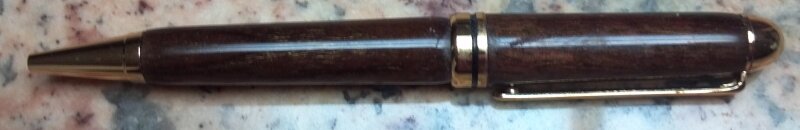

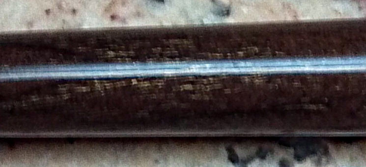

I used rub n buff gold on this walnut barrell to fill the pores in the walnut. I Cleaned off with sanding prior to CA fnish.
The pic is a bit blurry but you can see the effect.
Here's the whole pen
