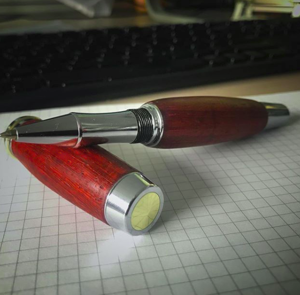

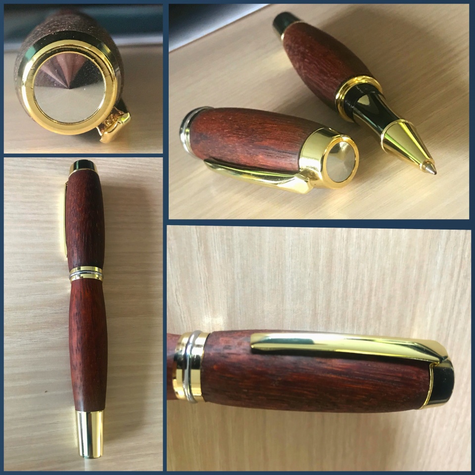

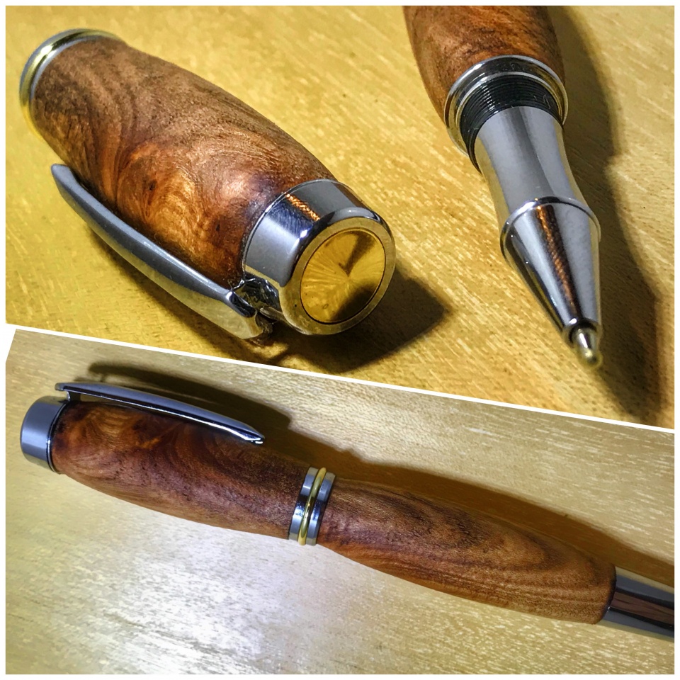

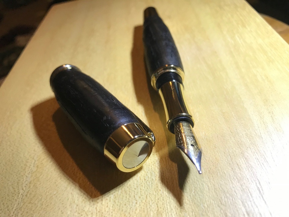

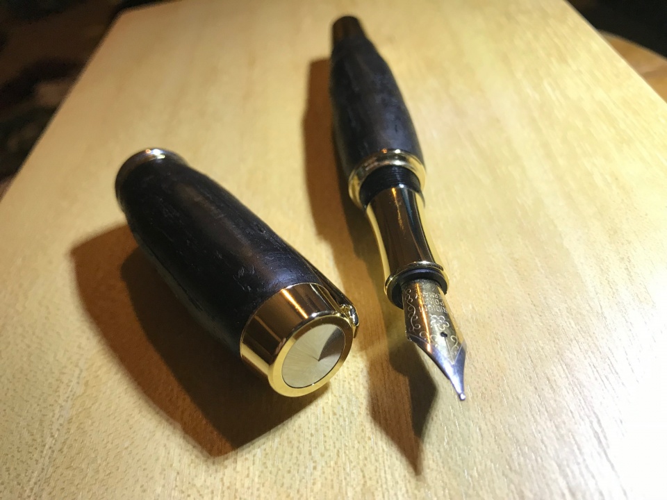

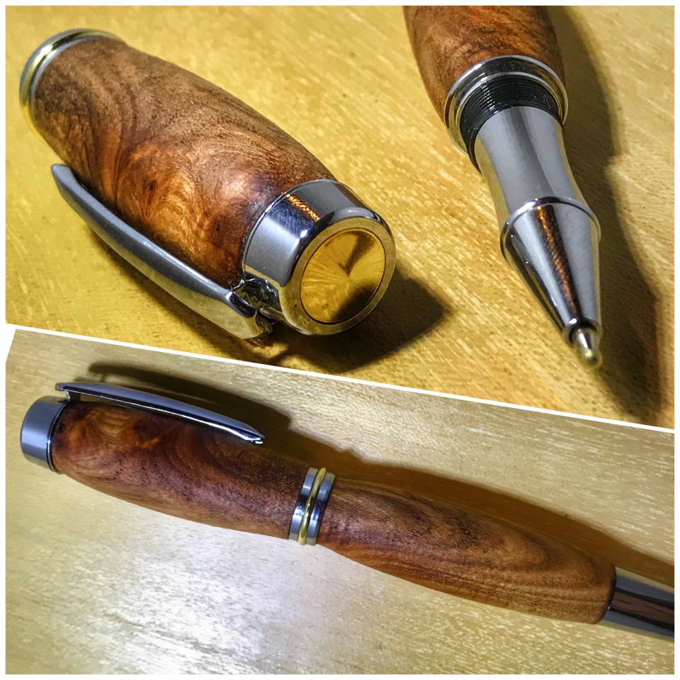

Hey guys hopefully i will find here in this usefull page anything that i need to improve.
by the way my first pens :)
Mahagon
padouk
Elm
Subfosile oak 7500y old
but i think am stacking with finish its hard to find exact supplies in local shops.

Welcome Dominik.
Great wood and nice pens. You are doing great for first pens and I know that you are excited. These are better than my first few!
You did ask and I will pass on my observations - there are two things that may improve the pens:
It appears that I can see either turning (chisel) marks or course sand paper marks. I would guess chisel. That would suggest chisel needs sharpening. If it was sandpaper, finer sandpaper will take the marks out. Also, sand parallel to the lathe - or longways when the lathe is stopped.
If it is the chisel, very few people come into pen making with the ability to properly sharpen a chisel for turning pens. That usually comes later after they have turned several. :smile:
Another thing about the marks is that sometimes that is from the type of chisel used for the type of wood. If you don't have carbide inserts on a chisel then you will have to sharpen the chisel.
On softer grain woods - a skew does much better;
On harder woods, a skew will work good but a scraper will work better on very hard woods in general.
Hope this helps. Lots of great helpful people here with lots of experience!

hello :) thank you for advose and nice machine i jist today receive new lathe :) this first pen i made in smaaaal micro proxxon lathe :) i know about sharpening and all this staff :) we will see in new pieces
