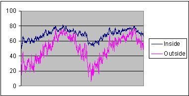

With an almost identical sized attached garage as my shop, I used one of the enclosed oil filled radient heaters on a timer and three of the heated floor mats. I would run the radient heater for 6 hours a day, and here is 2 years worth of temperature data, inside and out checked twice a day, once in the morning and once at night.
During the winter I put up plastic sheets over the windows to cut down on heat loss.
When I wanted to make sure glue cured nicely, I would put things over a heated mat and they would stay in the 70s on the coldest night.
