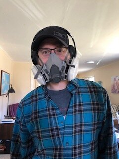

Hi everyone. Thanks for your help in my pen turning hobby.
When I first started I noticed there were some ill effects of being in the shop. Headaches, stuffed up nose, sinus and throat irritation. I thought I had covid. I was using alumilite resin at the time and decided that it was just the dust from that. I started wearing a 95 paper dust mask. I'm sure it helped. I upgraded and got a half mask with dual filters (which is actually way more comfortable), but I still feel like garbage for a day or two after I turn pens. I got one of those overhead dust filters for the woodshop too. It doesn't seem to matter if I turn wood or resin anymore. I have a beard, so mask effectiveness is limited. I searched here but couldn't find a similar topic, so I thought I'd just ask. At this point, I'm regularly using an arsenal of chemicals that could be the culprit-- CA glue, the accelerator, epoxy glue, spray paint, exotic wood dust, and my original theory of alumilite dust.
I just wanted to ask if anyone else has had this issue and how you've solved it. I might need to get a full mask. It's gotten nicer out, so I can open the window at least to get some extra ventilation. Thanks again. You guys are always a big help. :cool:

Todd,
I have a beard which I refuse to give up. I used the half mask as you do. It helped, but it is not effective if you have a beard. I eventually spent the money and got the Powercap from PekeSafety. Works great for dust. However, it will not provide protection for fumes. There may be filter upgrades that do so, but I did not do that research when I made the purchase. You may already have looked into the various full masks available.
TrendAir is the other full face mask in the same price range and is available through Rockler.
3M has one but that price is way out of my price range. It may be suitable for protection from fumes.
For dust protection. I got a trend air shield and that's great. For fumes don't know as yet. I have a dual filter mask but the filters , I have just found 🤦‍♂️ ,are not chemical fume rated so that was a waste of cash !
I will be looking at some of the 3M full shields as, let's face it , you only get one set of lungs . Do have a full dust system and use it but must get it better set up at the bandsaw as often forget it if " just doing a few cuts" which is dumb I know !
Like Ian, @howsitwork, I have and use the Trend Pro Shield. Sinus conditions went away as long as I wear it...all the time. As for fumes, like CA, it won't help. I don't use CA as the fumes really get to me and I'm tired of getting a bloody nose with the slightest sniff of the fumes. At times I'll forget to use the shield and later in the evening I pay for it but I do have some nasal spray the Doc gave me that reduces the inflammation in my nose/sinus's.
I don't have the Trend or PowerCap, but I am sure you can get replacement filters that stop the CA fumes. The Filters are the key to the shields and respirators working properly in CA environments.

I have a full beard and find a half face respirator very effective at eliminating issues I have with wood dust and CA glues. Without a doubt respirators are more effective when you're clean shaven, though I do get a pretty good seal with a beard. A quick down and dirty way to test your seal is to cover the filters with your hands and try to take a breath- pull in through your mouth pretty hard. You'll feel any leaks around the mask as the air seeps through. When I wore a respirator clean shaven I could not get any air around a properly fitted mask. With the beard, I can make it leak but I have to pull pretty hard to get a little air around the seal. IN MY OPINION ONLY, I'm getting a lot of protection with a beard because the filters flow enough air that I'm not creating leaks when I breathe in. With the respirator I can't smell any of the chemicals I use, which means (again, in my opinion) that the respirator's doing work for me. Another biggie is using the correct filters. There's no way to tell from your pic what your filters are, but the filters must be rated to filter VOC's and other chemicals. A particulate only filter WILL NOT do anything for chemical protection. I use filters that do particulates and chemicals, killing two birds with one stone. As a side note, N95 masks (which are dust only) do not work as well with a beard because there's no rubber seal. Some wood dusts make me feel pretty bad and I've noticed that a regular N95 helps but does not make it go away completely. Hope this helps!
Thanks Chad.
I have just purchased a pair of 2296 Filters (3M, #60926) which will filter a lot more than what I currently have (olive-magenta, if you're shopping by color). I will do the seal test that you suggested with my current mask with the new filters and make adjustments until I get a decent seal. Upgrading to a full mask is going to interfere with my glasses, but is not out of the question if it's for my health.
ALSO, I purchased a 13' hose for my shop vac (and cyclone that my wife got me for Xmas :cool:). I have gone back and forth between running the shop vac to suck fumes and dust away from my face, to turning it off because I think the vac is just blowing fumes and small particle dust evenly throughout the room. With the longer hose I can pull fumes/dust not just away from my face but to the house exterior by placing the shop vac outside.
Todd
Thanks Chad.
Todd
Looking at the specs for the 60926 filters. Those look like the full monty! I use the 60923's and they do the job, but hey..... why not? Using those filters you should not smell any foul odors at all. If you do, then you know the respirator is leaking. Your shopvac and cyclone can be a great solution to help control dust and particles, but do nothing to filter any of the chemicals. In fact, if you turn resins and collect the "dust" with the shopvac/cyclone it'll stink like resins every time you turn it on until you change out the filter(s) AND clean the insides of the canisters. If you have any additional filtration (I have a ceiling mounted air filter) the same thing will happen.....don't ask me how I know. The shopvac could potentially help with VOC/chemical control if its exhaust goes outside your workspace. Otherwise, it's just being circulated around the room. If you can smell it, it's still there. Sounds like placing the shopvac outside is a good solution, but remember the longer the hose the bigger the drop in suction.
Yeah, I'm planning to see a loss in suction, but hoping it will still have enough to pull the vapors and dust. I'll find out on Saturday when Amazon delivers.
I didn't bother to research what chemicals I'm filtering for, and spent the extra $4 to get the everything filter. If all I need is the 60923s, I'll just go for that next time. 😎
