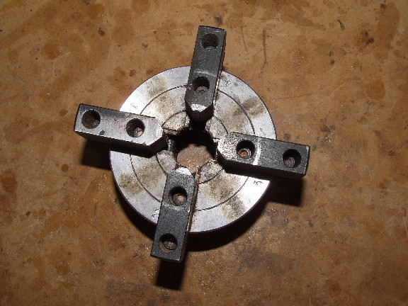

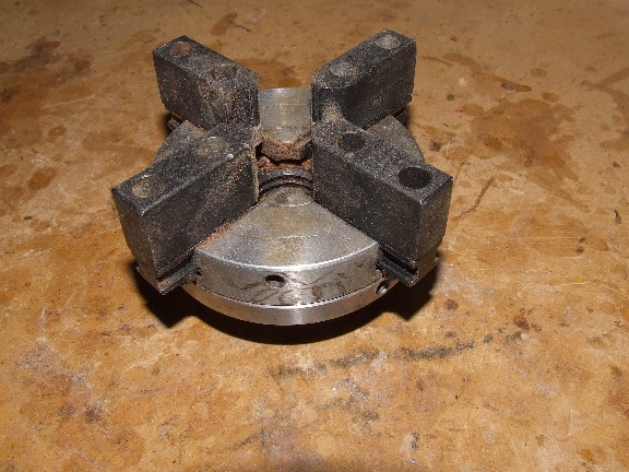

There are probably tutorials for the lathe drilling, I can't think of one right now, but it's pretty simple and a much better way to drill... after reading several posts from the brethren on IAP, I converted about a year back... much better success with almost any type of blank...
I have a little cmg3 chuck that I got from PSI about 8 years ago.. used it for a few things, and finally figured to use it on drilling blanks... it came with 4 small bars as part of the jaws... with them I can grip almost any shaped blank.. then you just need a jacobs chuck in the tail stock to grip your bit... lock your tail stock down, then use the quill advance to push the bit through your blank... stop regularly, pull the bit back to clear the hole, run the quill back to starting point, push the bit back into the blank and advance forward again... my little 1014 only has about a 2 inch quill travel, but my big lathe will travel almost 4 inches.. so I use the big lathe most of the time.... I normally drill at 450 or 600 rpms.
When I'm setting up, I usually keep the jaws loose, loosely holding the blank between the jaws and the bit until I've aligned the blank with the bit...then I then tighten the jaws... this works with odd shaped, out of square blanks, round blanks, antler, etc...
Once you try drilling on the lathe, you'll not go back to the dp..
This is the chuck I mentioned..

John,
That's a great tutorial... I knew that had to be some out there... it uses the premise that the turner is working with a collet system, I don't but I can see where the should never be a failure... I use my jaws to drill the square blank.
