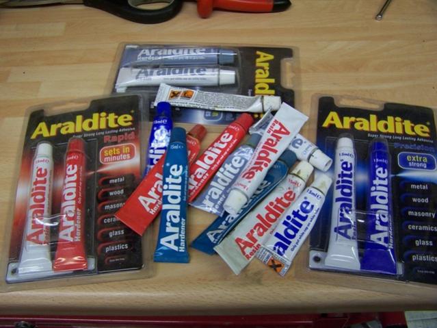

I rarely use epoxy unless I need the gap filling properties...
but when I do and as they are colour coded, I have never ever never ever ever ever ever:tongue::rolleyes: mixed a resin and hardener that didn't match:clown:
