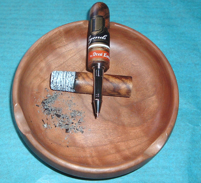

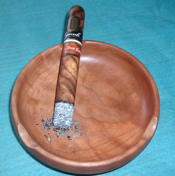

I realized too late that the lower label was not in line with the other one. Oh well!
The wood is a tigre caspi blank that I got from Mark James about 2 years ago.
Not my best work but certainly not my worst!
Thanks for looking.
Dale
Dale Allen
Oct 27, 2012
1,384
Massillon, OH
The kit is a Jr Gent II from CSUSA, chrome. I don't use high end kits because none of the 'bling' hardware parts are used or can be seen.
Making of the ash is, in simplified term... contour and carve to shape, apply black paint for background effect, when dry apply white correction fluid, cut lines with a v-knife. The final step is using a #2 pencil to tone down the white and then spray with matte acrylic.
Perhaps when I do the next one I will take some pictures showing the steps.
