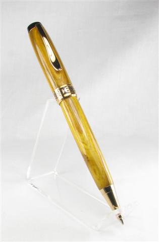

Hello Chip; Here's a pic of a turned Perfect Fit pen to give you a perspective of the measurements of the completed pen.
attachment.php
I'm not able to put the measurements on the pic directly, but hopefully this will help you see it is not a thin pen or an overly large one!
Where the nib meets the wood .3675", where the wood enters the CB .4740", the CB itself .5460", at the clip .5005".

Mack,
That's a good looker! I was talking about the really thin ones. But that's a good looking pen/pencil.
