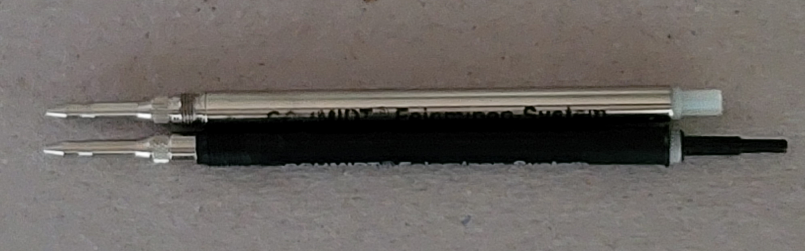

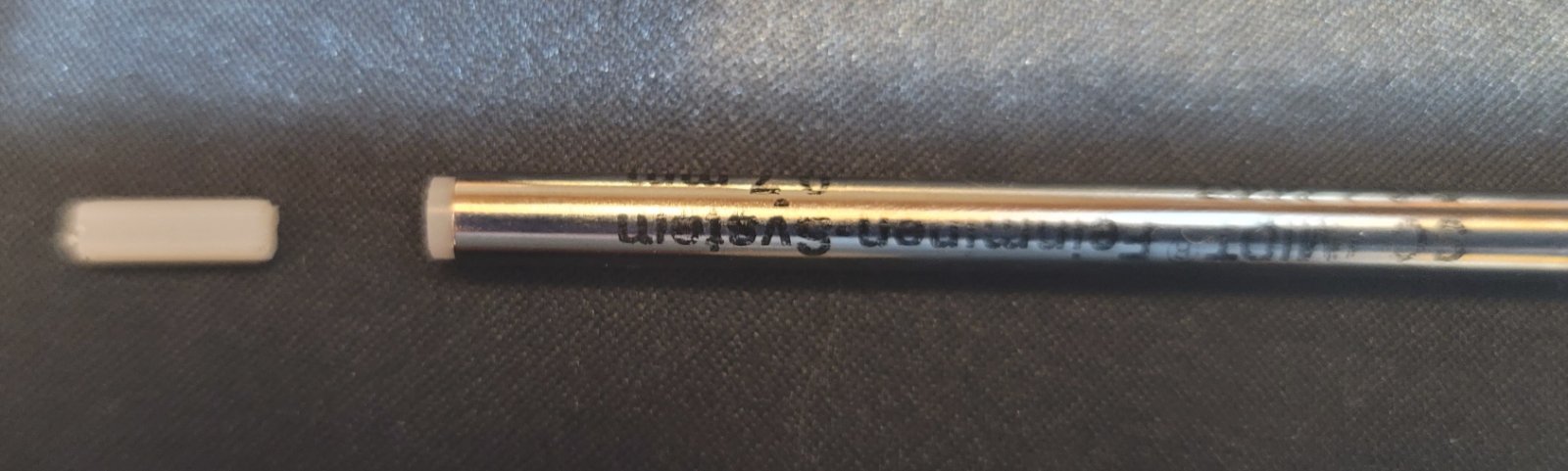

Just did that today! It may require a bit of initial fitting but then works perfectly. It only works on transmissions that sit behind the refill and push it in or out.
Turning like you're advancing the pen tip pushes down on the mechanism to advance the lead. Then you turn it back like you're retracting the pen to "hold" the lead in place.
There's a black plastic plug at the back end of the mechanism. You may have to adjust the length until it's just right so the transmission isn't pressing the mechanism when retracted and pushes enough to act like the clicker when extended.
Hopefully the attached picture shows what I mean. I replaced the black plastic plug with the piece of white plastic you see, and filed it down for the Everyday Classic at the bottom. But I tested in the twist pen above this morning and it worked fine.

Based on your success, I swapped out the ink refill in the PSI executive, and installed the Schmidt DSM2006, and after a little fussing, I was able to twist the transmission and advance the lead. I was not, however, able to retract the lead when I twisted the transmission the other direction. I do appreciate you looking further into this, but I think I am going to explore getting the Endurance refill, as it would be more seamless to use as a pencil.
Kevin
Yeah, twisting and holding in one direction is equivalent to pushing and holding the button on a click pen. Un-twisting won't retract the lead. It's just equivalent to letting go of the button. To retract the lead, you would have to twist and hold, then press the lead back in while the clutch is open. Just like how with a normal click pencil you have to hold the button down and manually push the lead back in.

That's not quite how it works. You have to twist *both* ways to advance the lead.
Twist it to extend, and the lead advances, but can also be pushed back in. Then you twist it back to 'hold' the lead in place. If you need more lead, repeat the twist forward-twist back. To retract the lead, twist forward, push it back in, and twist back.
Twisting forward=pushing clicker down and holding
Twisting back=releasing clicker

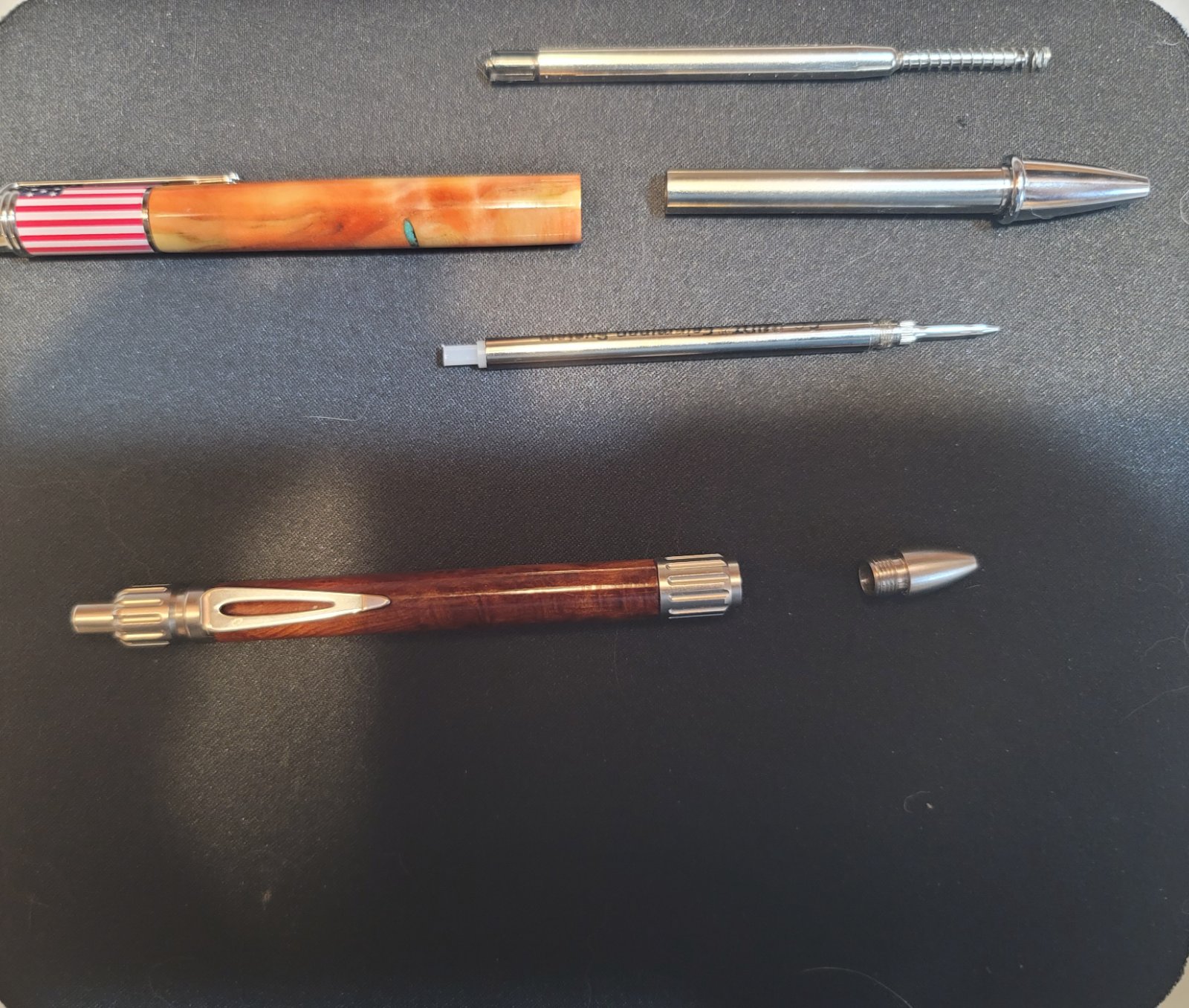

Also, depending on the kit, it may not work out of the box--the plug will need to be shortened. This is the plug I use in my PSI Everyday Classic. It also works on the American Beauty above
Click the plug a few times to extend a bit of lead, then put the mechanism into the body. Make sure the clicker or transmission is fully retracted. Slowly screw the tip back on, tapping the lead every half-turn or so.
When the lead slides back in, stop. The remaining gap between tip and body shows how much to remove; take the mechanism out and file down the plug. Lather, rinse, repeat, until the tip is screwed all the way on and the lead stays extended.
Be careful and don't remove too much, or the mechanism will be loose in the pen

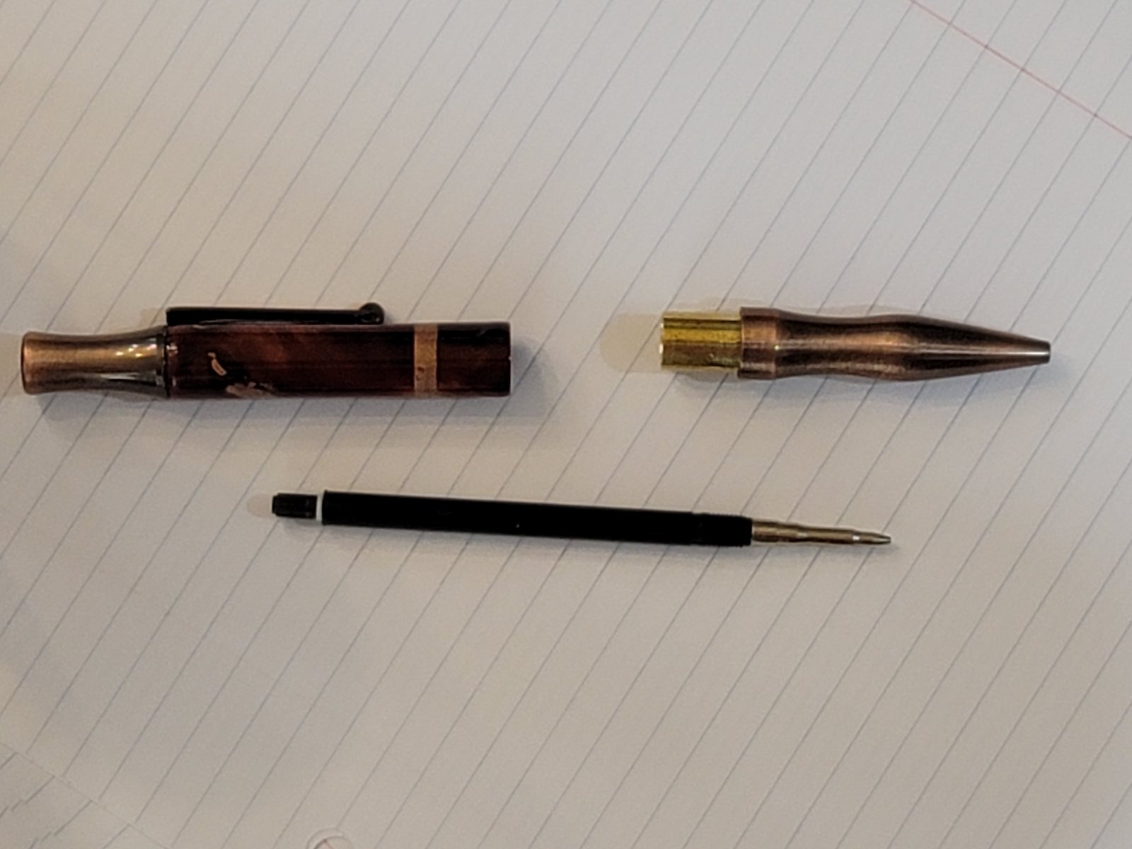

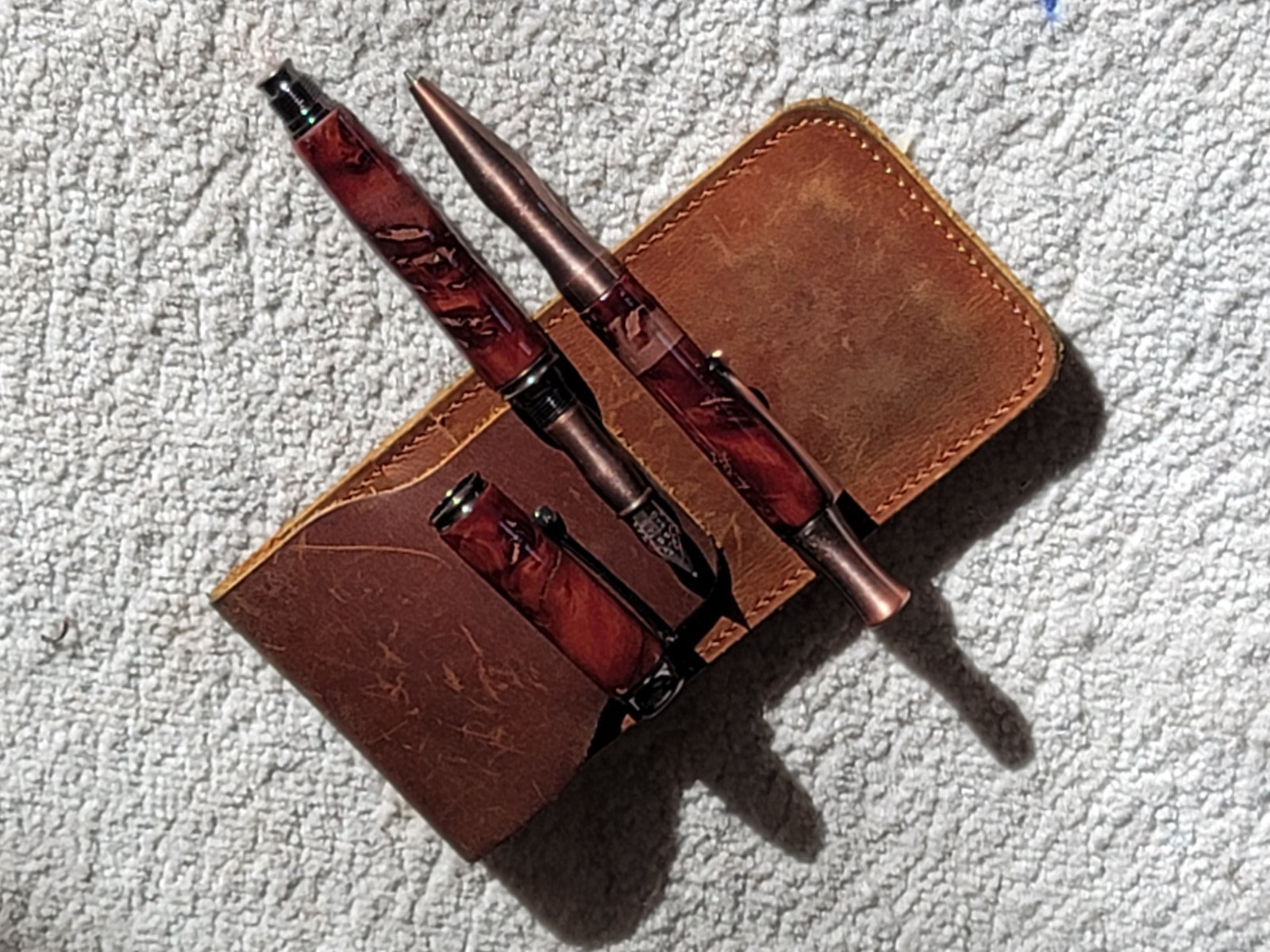

One final follow up, in case the horse isn't dead yet, and also there's another product that worked better than the Schmidt insert. My daughter just made a pencil using the Virage twist kit and the Parker-style pencil mechanism from Beartooth Woods, to match her fountain pen.
New to me, the Beartooth insert (https://beartoothwoods.com/catalog/product_info.php?products_id=4996) was really nice because it didn't need any fiddling at all! Just drop it in and it worked.
Good to know there are options! I didn't even know an alternative pen-to-pencil conversion for Parker style was available.
