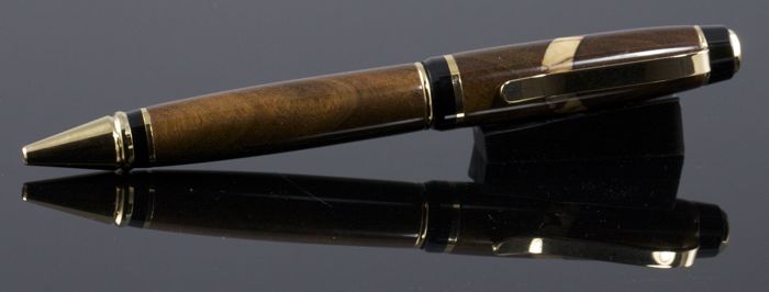

Here's mine. Ipe with Parallam segment. Leftovers from a friends deck install.
I tried to take a pic with my new phone, but the light sucks, the old bugger is finished in CA and I don't know which is harder, the wood or the finish. But nearly all the plating is worn off.

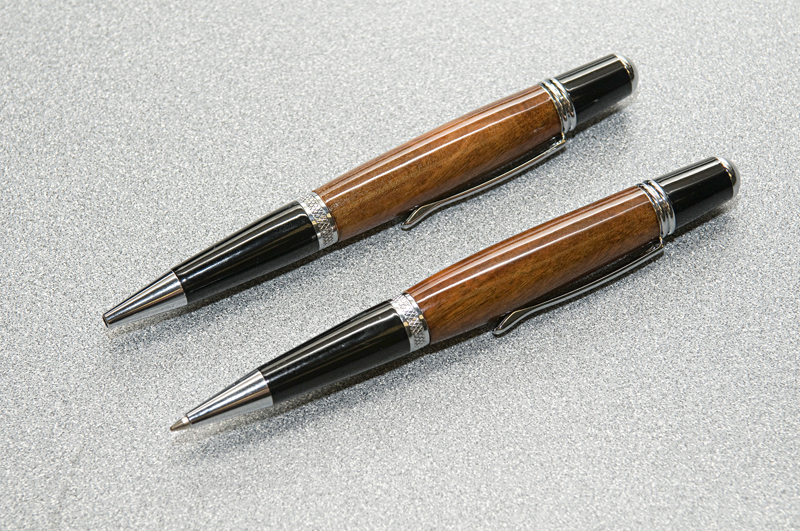

Here are a couple I did with Ipe. I've got a bunch of blanks that I cut from leftovers from a deck I made out of it, so they came from a 3/4 x 6 inch board that I cut at a 15 deg. angle. it's rather dense and hard, and if you're tools aren't sharp it will pull and tear, or just blow out if you're too aggressive. The stuff I have, being decking, is very plain, straight grained. No figuring at all, but it does have a nice rich red-brown color with some green streaks or speckles... It can be oily, so you need to plan for that if you're going to do a CA finish (start with some acetone...) but it would also do fine with no finish...
