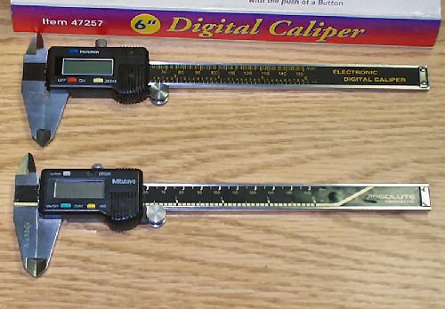

I think a much better deal is the Cen-Tech item # 47257 ?
I bought one of these from Herbor freight Last year, checked it in the calibrations lab and it is good to + /- .001" (mine was actually good to +/-.0005")
I think I paid $10.99 for it on sale. In fact, according to the website it is regularly $15.99
http://www.harborfreight.com/cpi/ctaf/displayitem.taf?Itemnumber=47257
And I'll be danged if it don't look and work just like a Mitatoyo!
Mudder,
The one that I got from HF looks just like your top one [:D]. Mines been used and probably somewhat abused but it still does it's job.
