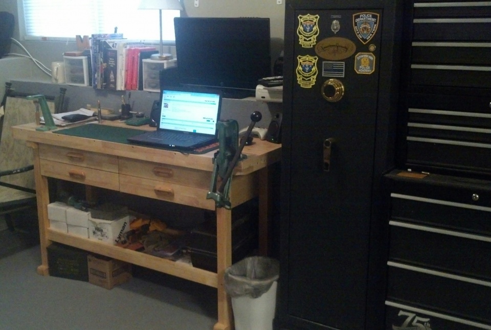

I've had mine about two years now. Use as a desk - reloading bench.
Love it!
