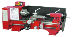

I want to turn a set of chessmen. I've bought a Harbor Freight 8X12 mini lathe
and a 2 in. chuck. I bought the chuck because i'm copying a video I watched on U-tube. Instead of turning between centers, this guy chucked the cylinderical
blank up to the head stock in an expensive 4-jaw chuck and turned the base of the chess piece first and after turning about half of the piece from the base up, he reversed it in the lathe and then completed the piece....Anyway, I thought it was a neat way to do it. I'm just not sure this H.F. 2 in. chuck will do the job.
I,m using 11/4 cylinderical blanks. there are no instructions with this chuck so I not sure which way to orient the jaws.
Anyone have any experience with this chuck?
Also, this chuck looks dangerous spinning around with the jaws sticking out like that!
If I'm looking at the correct one, the Jaws are stepped. If your material will fit with the jaws installed with the higher step in the middle use it that way. If not the jaws can be removed and reversed giving you three new diameters dependent on the step up you use.
Here's a link to a good article on that type chuck
Mini Lathe Chucks
And yes the jaws can bite, so watch the placement of your left hand.
See if you can find one of those old elastic wrist sweat bands in a bright color. Put that around the jaws so you know where they are as they spin. I'm a big fan of not getting my knuckles busted.

I have the exact same lathe and I think this is the chuck you bought.
2" Mini Lathe Chuck with MT-1 Shank
I had looked at these but decided to go with a larger but still small 4 jaw scroll chuck from PSI that was about $99 and was probably more like what that tutorial was using which gives me a ton more flexibility.
https://www.pennstateind.com/store/CMG3C.html
Maybe if you posted the tutorial we could be more helpful but I think you are going to have a very frustrating time with that chuck. It has very little contact with the piece and see a lot of flying wood in your future. :)
I turned my chess pieces on a pin chuck... I wanted to weight the pieces, so I drilled a 3/4 hole in the bottoms with a forstner about the depth of the cutter head (around 1/2 or 3/8" - I didn't measure the depth, just turned until the cutter head was flush with the bottom.... then a 3/8" hole for the pin chuck... about 3/4" deep.... mounted on my Beale collet system and turned away...then I could just dump birdshot into the hole and seal with putty. Easier than messing with a chuck.
I turn bottle stoppers the same way.
Robert

The only 2 inch HF Chuck comes with a MT 1 arbor. The lathe you selected has a MT 3 head stock and a MT 2 tail stock. The lathe comes with a 4 inch metal Chuck as part of the package. It is usually a challenge to get a MT 1 to work,in,a MT 3 head stock.
While not the best Chuck for wood, the stock Chuck is a better bet than a smaller one. Any particular reason you are not using the stock Chuck that came with the lathe?
Perhaps you are using the Mike Peace videos in,making chess pieces?

I'm assuming its this lathe Benchtop Wood Lathe - 8" x 12" which uses mt 1 for head and tail stock.
Not this one 8" x 12" Benchtop Lathe
