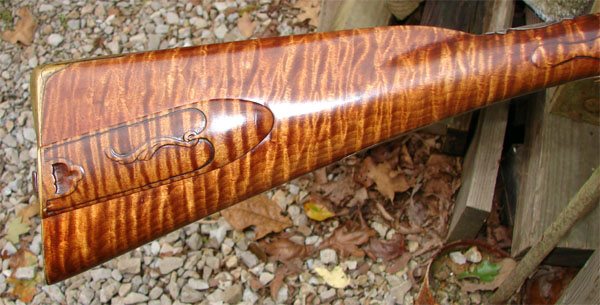

Dilute nitric acid is still used by those who build traditional style rifles and it works just fine. Takes patience but results can be stunning.

See below for an example of what the acid can do with curley maple.
Frank, I have a good sized collection of weapons and I have nothing with that caliber of finish. That is a beautiful stock. Any chance that it might be for sale or is there a way to make another one? That would look great on my antique side by side 16 gauge that is hanging on the wall but is still very usable(but won't be used).
I'll contact you, off forum.

Enneyhow...the technique is simple but laborious. When your stock is finished and sanded, dilute the nitric acid quite a bit. No set ratio, whatever works for you. Apply to the wood and wait a bit. The stripes will darken a little. Continue applying, each time the stripes will darken some more. When the desired degree of color is achieved. Rinse with a neutralizer. Of course, you have wet the wood and will need to sand again. However, the stock you see was wet, sanded, wet again, sanded again numerous times. Each wetting raised 'hairs' which had to be removed. Some old time makers use broken glass and rub/scrape the hairs off to achieve a final smooth surface. Many-many hours can be invested in a project like that.

Acid is well known for maple and you will get some stunning effects from it. It is the best treatment I have seen to date, somewhere is a board of test blocks. I will see if I can find it to post. I saw it on the muzzle loading forum a few ago.

The why is because that is what was found a couple centuries ago that works on figured maple. How? Ask a scientist, I dunno. Dilute with water. Be careful. If you pour water into the acid, or the other way around, it is dangerous. I can never remember which is right and must look it up each time.

I have absolutly nothing to add, just wanted to say what a great thread! Thanks all for the interesting input. And WOW, that is one of the most beautiful rifle stocks I have ever seen. Got a picture of "The Rest of the Rifle"?

Frank, when do we get to see the rest of that smoke pole? :D
I almost forgot I promised to do this. Hopefully soon. My mower had been out of service and my lawn hadn't been cut yet this season. Got it fixed yesterday and did some cutting. More today. Maybe later.
