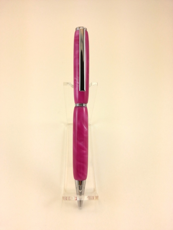

TBC to fix ellipital bulge after using mandrel (hopefully the last time)
Made my fist two tonight - totally different experience. I have two or three more queued-up for tomorrow as the 15 min epoxy cures.
I was wondering if there was a way to fix a small elliptical flaw on 1 of the 6 separately turned barrels that I made yesterday using my fickle (and hopefully obsolete) mandrel.
Any ideas as to how to remove the slight bulge, by TBC.
See if you can spot it on the pic. It is right above the center band on the upper barrel. Thank you.
Special thanks to Constant today (of Laserlines). He has an incredible shop and he is an outstanding, skilled, and generous individual .Tough buying PSI kits after seeing and feeling the quality of his work. And I am only 2.5 miles away!
Nice to American-made quality! I know we have other gifted vendors/partners that practice the same quality of work. We are a blessed group!
Extra special thank you to Harry (of WV). He gave me the confidence and instruction to get it done.
