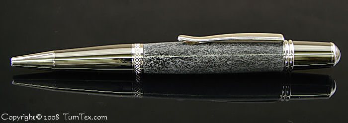

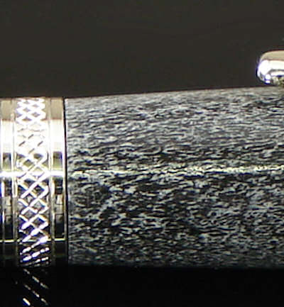

Guess the material used for this Sierra. It is not wood and is not dyed.
No one close, yet! Remember, I said it was not dyed. That does not mean it is not artificially colored. It is based on a natural material, BTW!
I was thinking corian but that wouldnt be Curtis, how about chewed up bluebonnet seeds that were removed from the mouth of endangered blue jackelope that only lives on the west side of I-35....;)
Ding ding ding...we have a winner!
It is a piece of Axis Antler from an Axis deer that I shot a while back. The Axis was still in velvet so I did a skull mount and removed the velvet myself. Because it was still in velvet, (read, still growing) the antler was very porous and light. Unfortunately, I hung the mount over the door going into my shop and one day it decided to fall and shatter on the floor!
Seeing an opportunity, I decided to cut it up into blanks! Due to its porosity and the fact that I will cast anything:D, I put it in a mold and pressure cast it with black Alumilite to see what would happen. The Alumilite penetrated completely and did a really good job of making it usable. Not overly exciting as a material but unique nonetheless!
Its Black Axis. But I cheated
