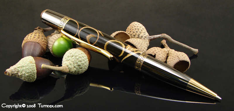

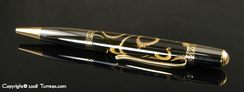

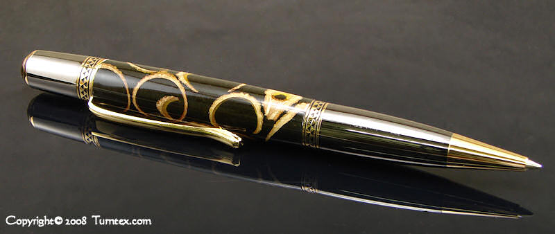

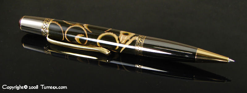

Time for another "guess the material" thread! This is a natural material cast in resin. This is obviously a Tapa Pacifica with a CA finish on the "material".
Comments on the pen are also welcome, good or bad. Thanks for playing and looking!

I'd know that stuff anywhere. I've made whistles with it for 30 years. It's acorn shells.
Nice looking pen, I like the combination of colors.
Well that was easier than I thought it would be! I really did not think anyone would guess this quick! It is indeed acorn bases from a live oak in my back yard. Let me state this clearly, this was not my idea. Someone posted in the casting section about using acorns and it was suggested to possibly be able to use the base. I decided to give it a try and see how it came out. Pretty cool, I think!
I took the bases and dried them in my toaster oven for a couple hours at 200 degrees. Then I mixed up some water clear Alumilite with a little amber dye and poured the acorn bases into my mixing cup and mixed them in. I then poured it all into my mold and applied 80 psi pressure. I got zero voids and the casting came out great. The resin is quite clear with an amber tint. The inside of the blank is colored black.

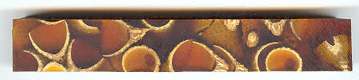

Anyway, here is another pic with the raw material to give an idea what I started with.
I went back and looked in the casting forum and I need to give credit for the idea to Jeff Powell. He posted a question asking if anyone had tried casting acorns and that gave me the idea to try the caps.
