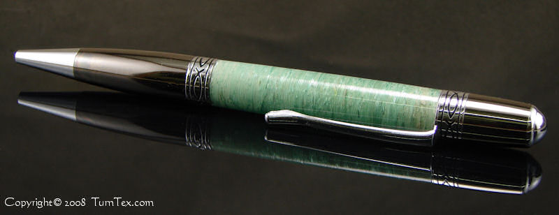

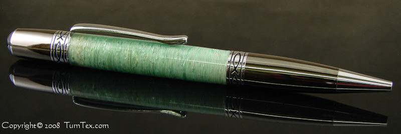

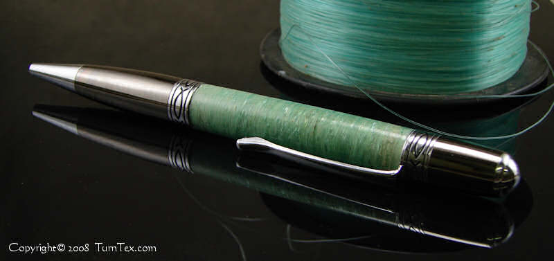

Seems like everyone liked the last time I posted one of these "guess the material threads" so here is another!
The material is man made and has not been cast, what is it?
Did anyone catch the play on words? Since it is new fishing line, it has not been cast yet! Ha Ha! Anyway, I took the tube and put it on the mandrel like normal. I then put a little thin CA and stuck one end of the line to it. Once cured I turned the lathe on at 350 rpm and wound it onto the tube. Once above the bushings I soaked it all with thin CA and let it cure. Then turned and finished, adding CA as I went to keep it all together.
