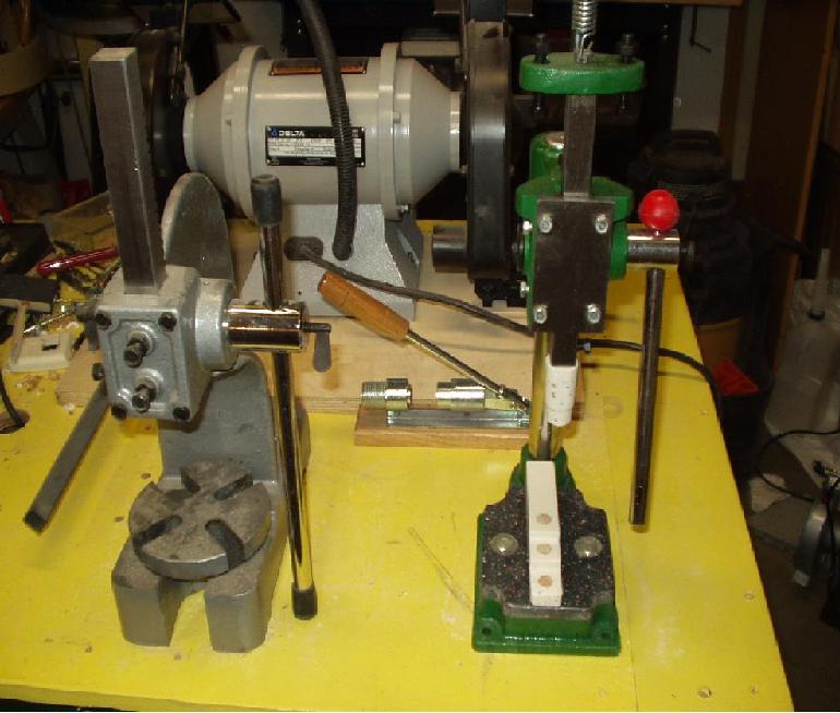

As Requested... The 3/4" plywood base for the Big, Heavy Delta slow speed with Wolverine System mounted. You can't see the bolt anchoring the plywood to the bench top...
That's my arbor press and pen press...

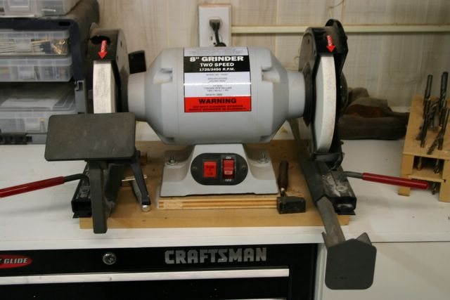

I have to agree with you here Frank (Imagine that?) The only way I would trust MDF for mounting tools is if it were sandwiched between two pieces of plywood.

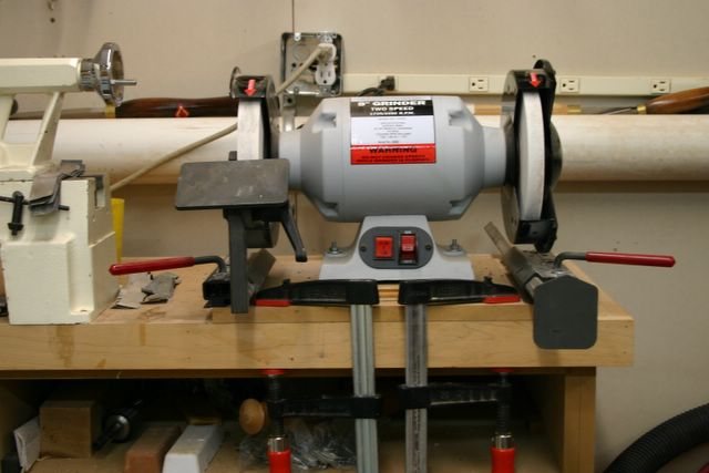

I have my grinder mounted on plywood and I can clamp it to my tablesaw or "portable workmate" when I need to sharpen. Since I mostly use my radial arm saw and bandsaw the grinder sits atop my tablesaw until I need it and then I just un clamp it and move it aside.

John, how did you know I had an mri?[:D] You are absolutly right that you should not use the grinder with out the shield. I have been having issues with the wheel running out of balance which is why the shield is off. The pictures were taken as a result of the posters question and caught the grinder while I am trying to figure out the balance problem. I am going to post a question in another thread as to thoughts on rectifying the problem. Thanks for the safty reminder [:)], Dave.

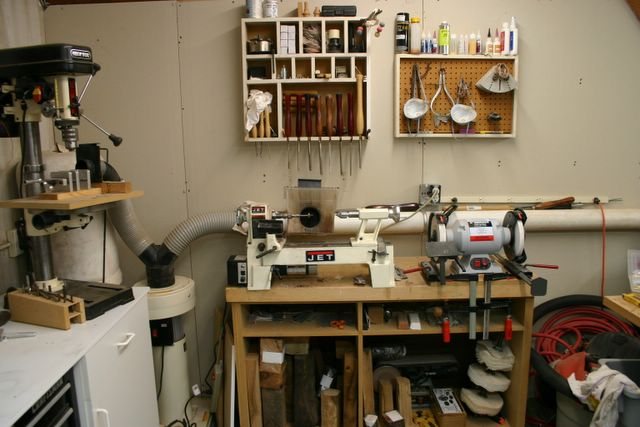

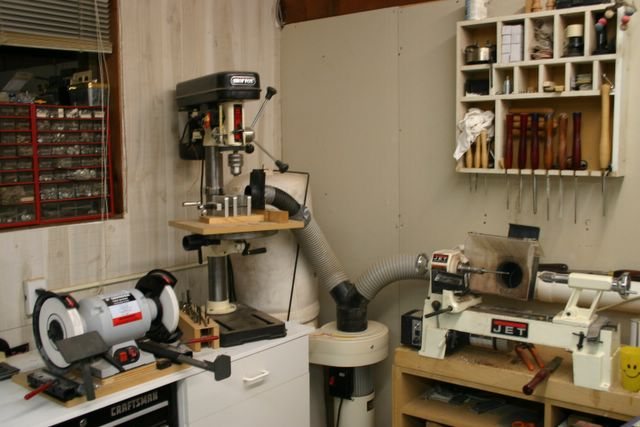

I am so glad that I read this post. I am a new member, (for almost an hour now, Starting to feel like an old member) and I have got so much from this post. I have ordered the wolverine sharpening system and have been thinking of how to mount it. Your post have helped by alot. One of the things that I have really enjoyed was seeing how your shops were set up. I have been wanting to see others shops for so long. I have a shop that I build with some help from my friends that is 16X20 in my back yard. I am so cramped for room that I can hardly move around in there. I wish that I had doubled the size in the beginning but I build what I could afford at the time. I have so many tools and so little room. The tools I don't complain about, I room I do. I would love to see pictures of others shops and any advise on making the most of limited space.
If it would help I could take some pictures of my shop, but, I would need to clean it up before I took pictures.
