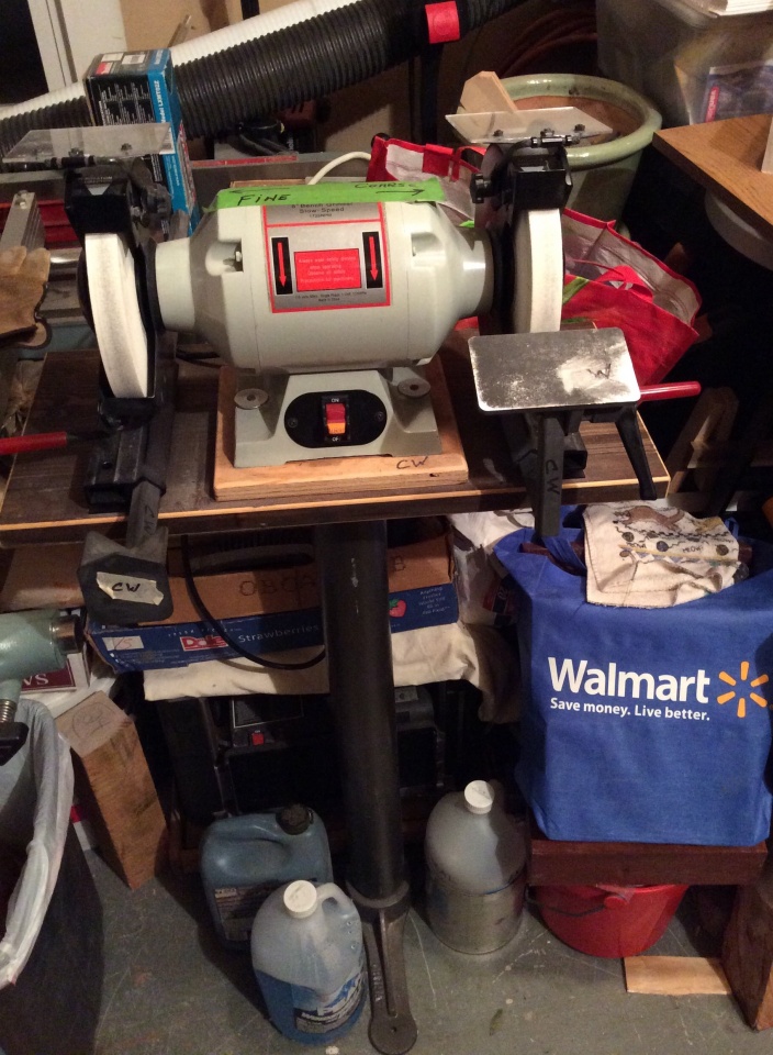

Here you go Dan.
This uses a full 1" thick board on a stand. I picked up the stand at a sale but it was too short for me. My niece's husband found a drive shaft that fit the top and bottom flange. He cut and welded the shaft.
This one is 36" from the floor to the bottom of the board.
I was tired of bending over to sharpen.
Disregard all the stuff piled up.....space is at a premium! The Walmart bag has wood blanks from the Virginia Woodturners Symposium last summer. ....maybe I should look and see what we bought!
