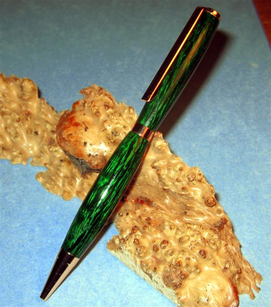

I took pics step by step of the dying process..this was the first time I have ever tried it with lace wood..I'll post the tutorial as soon as I figure out how:)
Copper slimline with green dyed lacewood
thanks for looking
Okay. It's been awhile. Can you tell me how you managed to get such a beautiful color in this lacewood?
First, use a wood that will allow the grain to show through, some of the ones I have had success with are tiger maple, buckeye burl, lacewood, briar burl and corncob

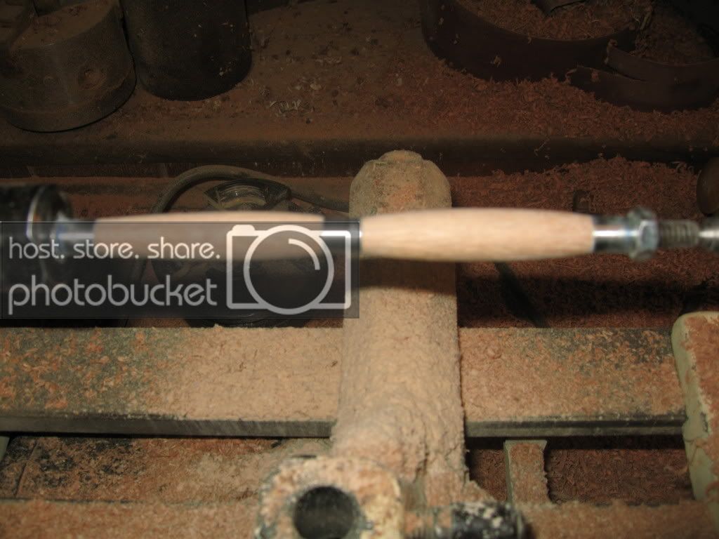

Cut and drill your blanks glue in the tubes and face the barrels as usual, mount and turn to size. only sand to about 600 grit Here I am using lace wood

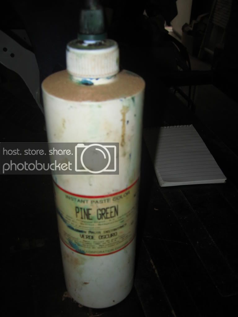

This is the brand of food coloring I use. It is available from sugar craft http://sugarcraft.com/catalog/coloring/liquid.htm

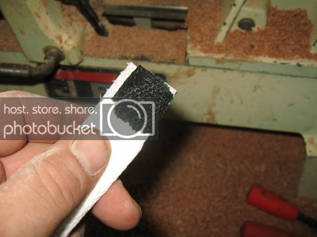

Just a few drops on a paper towel

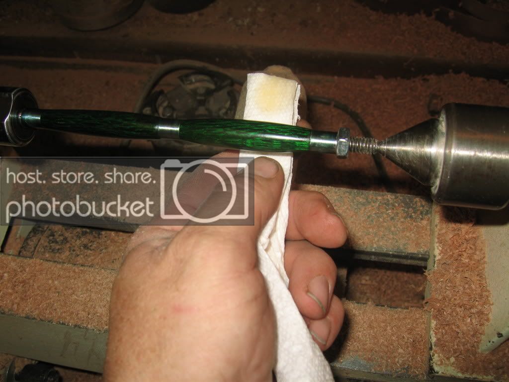

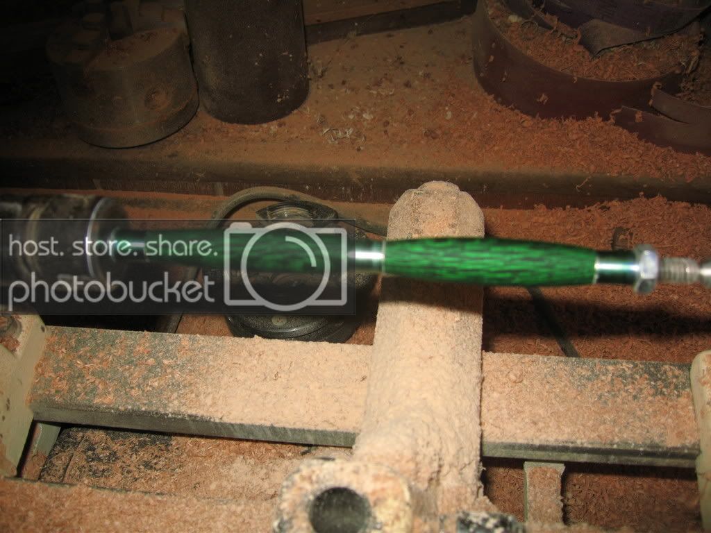

Apply the food coloring until the blank Is a uniform color
Let it dry for a few minutes then give it a quick coat of B.L.O.
I now do a CA/B.L.O. finish. I apply a few drops of b.l.o. to the paper towl, I apply the ca just below the moistened part of the towel, one pass across the blank and then move the applicator down and smooth out the ca with the section moistened with blo
I do 6 coats of medium ca, let cure a few minutes then a light spray of accelerator..

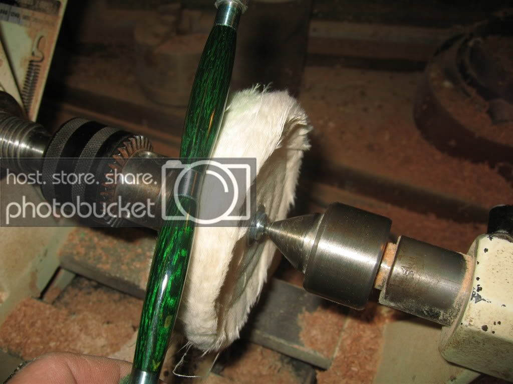

I then lightly sand starting at 3200 micromesh to 12000 micromesh
A light coat of Mc Guires scratch and swirl remover then buff
Hi,thanks for your tips,i have been doing a lot of dyeing with anniline dyes,i think the dyes what ever type really give a so so blank a real kick and it isn`t that much more trouble then normal,i come to think,perhaps i`m wrong but they look just as good as dyed stabilized blanks which cost 3-5 bucks a shot.Like you,once the dye is on i use micro mesh to smooth and then use brown paper bag.then CA and PP
