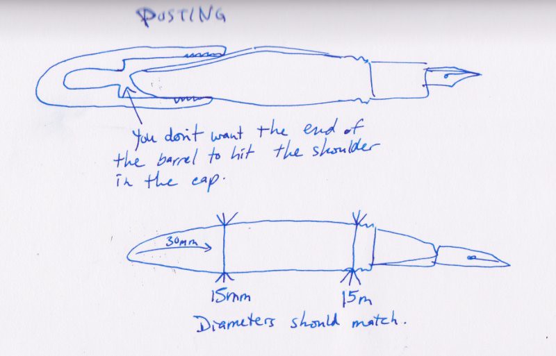

Posting:
I don't think depth matters so much as does fit.
I have a pen made by John Brady that posts very securely but only about 15mm down the barrel. I have others that post 30 or 40 mm down.
What I try to achieve to get a cap to post securely is to make the end of the barrel the same diameter as the cap threads. So if my cap threads are 15mm, then I want the barrel to be about 15mm thick about 20-30mm in from the end. I use an open end box wrench to sort of measure this. I've made some that should post deeper, but b/c of the shoulder inside the cap they couldn't post.
Also the curvature of the barrel makes a big difference. A straight barrel that gently tapers to the end should post pretty easy - but if you've seen my pens you see I don't make anything straight. I like to push the curve in a little at the back of the barrel. Not necessary though. Experiment with shape there as some shapes will take posting better than others. The gray stripey pen that was very point I just made should have been postable, but b/c of the fat curve going out from the center line of the barrel, it doesn't even almost post.
posting by snennewton, on Flickr
