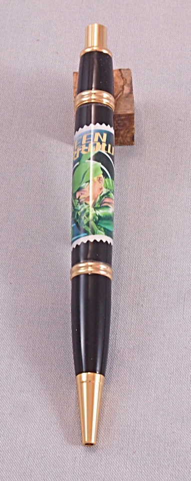

Postage stamp on Gatsby Clicker. This color combination really appeals to me.
Looks great! I have a sierra on order to put the Green Lantern blank on. I also picked up a bunch of Batman stamps at post office on Saturday. I want to try to make a stamp blank now!
I suggest that you use a 50-50 mixture of elmers white glue and water to adhere the stamp to your painted tube (use acrylic paint) and then seal the tube and stamp with this mixture before casting. Let cure, do not handle the prepped tube without gloves (to avoid getting oil on the tube) and then cast in PR. Good luck, let me know how it works for you.
