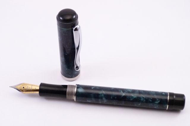

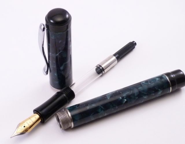

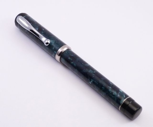

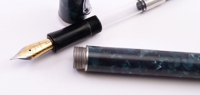

Black and green resin from Exotic Blanks, #6 Medium Meisternib. Black acrylic cap and barrel finials. 12mm triple lead cap thread. I nickel plated the brass coupler and trim ring.
Not intended to channel any particular style, though I am very much a FP traditionalist. It's more a platform for trying out the plating process. Balance seems OK despite the additional weight of the metal parts. This clip is perhaps a bit too heavy, both visually and weight-wise, but I didn't have a better alternative at hand.
150 mm capped
138 mm uncapped
38 grams
Comments and criticism welcome. Thanks for looking.
Roger

I see nothing wrong with the clip, heavy is always better for daily use anyway(less chance of prying the clip off in a shirt pocket).
Like the straight line of this one, and all the little details seem to have been thought of by you too!!
Scott (well done - like my steak) B
I think the size of the clip is fine and suits the pen quite well, I do however think the clips trim ring is too small in comparission to the trim ring on the barrel.
EDIT: On second look is the clips trim ring even exposed?
Overall a great pen!
AK
