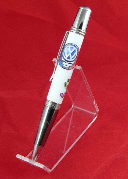

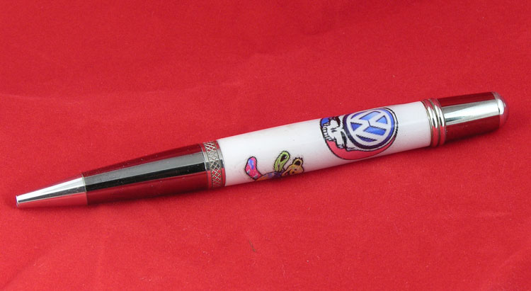

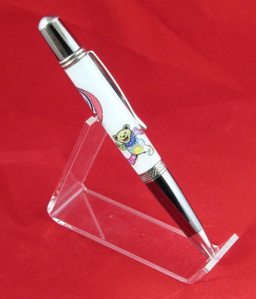

I made my self a pen, it's a Decal I made on a Powdercoated Sierra tube and cast in one of Charlies Resin Saver molds, the Steal your face has a VW logo where the Lightning bolt usually is and since I'm just an old hippie with a love affair with the most noble of the German Vehicles and have been accused of attending Grateful dead Concerts(I don't remember that many) I had to make this just for me, Making the decals is easy I can't believe how simple it is to make them, also there is a little dancing Jerry Bear near the bottom. the kit is a TI and Chrome Sierra from Beartooth woods,
