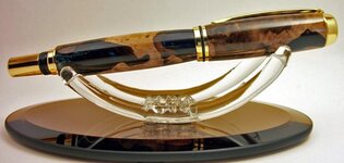

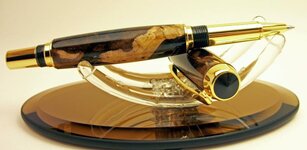

I stopped by a Yard sale yesterday and found a Grape wood pot hanger for $4, I took it home and cut some pieces off of it and Cast them in Clear Alumilite at 60 PSI. This is one of the four blanks that I ended up with. The inside is painted dark blue, there is a couple of thin spots in the paint where the tube kinda shows through giving it an aqua color. It has a CA finish sanded to 1500, MM to 12000 then plastix polished. It is on a gold Jr. Gent.
Any Comments Welcome, Thanks for looking. :biggrin:
Same yard sale I got the stand from. :biggrin:

Thanks everyone for the great feedback, it is hard to capture a good photo of this pen. Because it is cast in clear you can look right down inside and see the wood, it is like looking at wood under water. I think I will be doing more casting in clear.
Great Job I have turned about a dozen pens from grapevine if you want a cheap source go to home depot in the plant section, they are usally marketed either for pets or as decoration, I can find it for $5-14 depending on the size. The wood is very nice looking although it does have a tendecy to split and make good sections not very fun.
