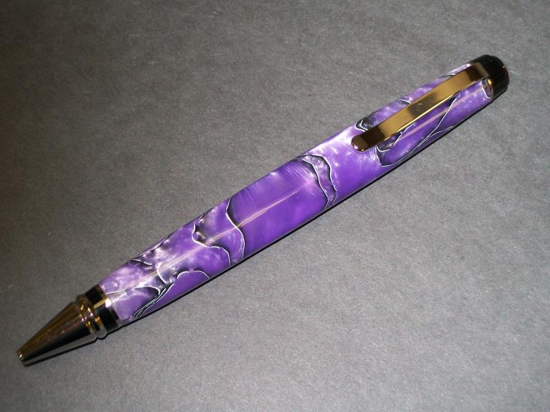

C coogman Member Joined Apr 3, 2010 Messages 3 Location Kentucky Apr 7, 2011 #1 This pen is made from a ultra cigar platinum kit. This acrylic blank is from woodcraft. Sanding and finish was done with micro - mesh sanding pads 1,500 - 12,000 and Huts ultra gloss plastic polish. This is my first post. Dennis Attachments 20110407_1.jpg 68.9 KB · Views: 444

O OutofTurnSam Member Joined Jan 11, 2011 Messages 38 Location Houston, TX Apr 7, 2011 #5 Is that a twist pen kit? How does it operate without the centerband?
C coogman Member Joined Apr 3, 2010 Messages 3 Location Kentucky Apr 8, 2011 #6 Thanks Sam. Yes this is a twist pen. You have to machine down the center band so it is even with the brass tube.

hilltopper46 Member Joined Jun 28, 2006 Messages 2,420 Location East Troy, Wisconsin, USA. Apr 8, 2011 #7 Great pen!! I'm confused about your statement about the Ultra kit as the clip, the finial and the ring above the nib look like the standard cigar parts.

Florida Marine Member Joined May 16, 2011 Messages 403 Location Jennings, FL May 23, 2011 #8 I love that blank, I made a slim line for my wife with it and its my favorite pen for some reason... I wish I had colored the tubes, you can catch a haze of the brass through some of the thinner ends. Nice pen.

Rangertrek Member Joined Sep 10, 2008 Messages 2,108 Location Bossier City, Louisiana, USA May 23, 2011 #10 Nice looking blank and great mod to the cigar pen. When I first saw the title line, I though you were referring to the 'PSI Longwood' pen.
