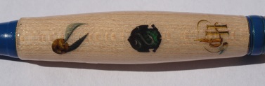

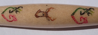

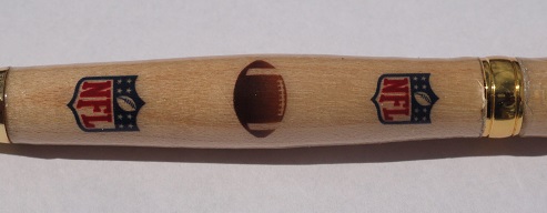

Depressed! Made 5 shimlines with decals just to see if I could completely hide the decal edges. That went well they are invisible even in bright sunlight. But every pen cracked a few days later at the nib or clip end. I used enameled parts, wondering if the added color thickness could be the problem as the press fit did not seem all that tight. They were end sanded with Rick H's sanding devise from IAP and I used a rat tail file to clean the inside of the tube and a gun chamfer for each end. The two I did with regular gold plating did not crack. Any thoughts are welcome. Once again the real test was to see if the decal could be hidden and that worked but the cracked pens are very frustrating.
Any comments and critiques are welcome that is the only way to get better. Thanks in advance.
Please note none of these are for sale they are just tests.
I also have had blank cracking problems after assembly and I also have attributed it to the extra plating thickness on some component sets.
I bought a set of adjustable reamers and now routinely ream out the brass tube ends just before assembly (you have to be careful to not scratch your nicely finished blank, or you could do the reaming before the finishing process). It takes a bit of practice to ream out the "right" amount. But even if you ream out a little too much, you can always epoxy the nib and finial into the tube ends.
I have had no end cracking problems since I started doing this.
Slimline have a very thin portion of wood at the ends that might not resist the part being pressed into the blank and the CA is rather brittle.
