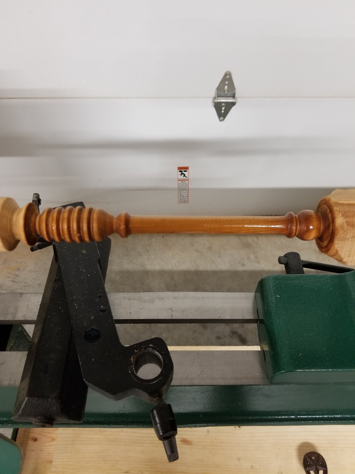

If you have a woodturning club anywhere near you, I would recommend checking them out. You can learn alot from them. When I got my lathe, I knew nothing about using one. I didn't have a club nearby so I watched hours and hours of videos on lathe safety, turning tools, turning different things like pens, bowls, etc..... before I ever attempted to turn anything. First thing I turned was a honey dipper. It gave me some experience with turning between centers and the use of a few turning tools. A lot of people use carbide tools now, including myself, which are a little easier to use in my opinion and you don't have to sharpen like regular tools. Just my 2 cents. Here's the first thing I ever turned. Good luck!

You can use a spur drive along with a live center to turn a spindle (Tool handle, Baseball bat, fence spindle). Personally I use a chuck and jaws for turning bowls or very long spindles that I need the through hole for. Of course, if you have money burning a hole in your pocket then by all means purchase a four jaw scroll chuck. Buying chucks is like buying into a tool battery brand. Buy into a system that will support your needs with interchangeable jaws.

As for workholding, a chuck is nice, but in most instances, you have options as stated already. If you are turning a handle, then a spur drive and live center work perfectly - just remember the trick to add an inch or so to the length of your raw wood which will be the handle to allow you to finish it nicely and then cut off the little extra where the spur drive tore up the wood. You can either part the small section off or use a pull saw to cut it off and then sand it clean.
