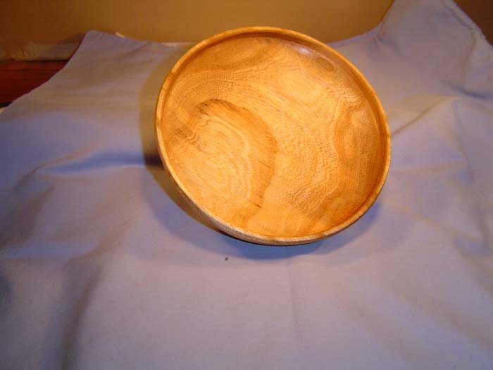

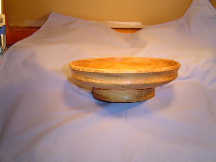

Iv'e been experimenting the last couple days. Cant call this a bowl or a dish.
It was 3-4 inches wider, and 3 inches deeper when i said "yes this is the shape
Now all i have to do is clean it up."
With every dig and catch a chunk came out. One good catch broke off a whole inch of the side. With every chunk i made it smaller. I figured if i didnt stop i would end up an attic pull again. Most of the shaping was done by scraping because i couldnt get it to cut right. Signed up for bowl turning class at local rockler store.
thanks for all the suggestions .....pete
