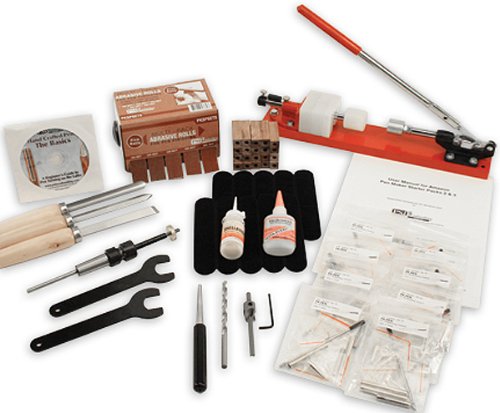

I saw this on Amazon:
Amazon.com: Amazon Pen Making Starter Pack 2: Home Improvement
It includes a press as well as chisels.
Together they come to under 500 which is sort of a self-imposed budget I have in mind.
Any thoughts? Anything else I would need?

Hand tools? Another neanderthal woodworker here! :biggrin:
The 10x18 Grizzly has a 1/2 hp motor. It's fine for pen turning, and probably for peppermills and such. If you get into larger stuff, which might not even be an issue with a 10" swing, it might be a bit underpowered.
As for that Amazon starter set, it's nice that there's a set that has all sorts of tools in it, and there's definitely enough there to get you going. Like a lot of combo sets I've seen (not necessarily for pen turning), they usually include things that duplicate what you already have--like that pen press. Since you already have a woodshop, you probably already have a bench vise. I use my big Record vise for pressing pen components together. If you have the room for the pen press, it would be nice to have a dedicated station for putting components together.
One thing I did notice is that the slimline kits have 24K gold plating. I've seen the finish wear off on some 24K pens, it kind of depends on how the pen is carried by it's owner.
The description says that the pen blanks are predrilled. Great for getting started, but you'll need to figure a way to drill other blanks when the kit ones are used up. A drill press works well, as well as using a four-jaw chuck with drilling jaws on your lathe.
Hope this helps! And, welcome from another woodworker who has more handplanes and braces than he probably needs.

Thanks for the input. I really don't have anything that would be redundant. I saw some videos where they use the press. I saw some with a vice. Which is the best way to go?

That looks like the PSI starter set there .... :)
