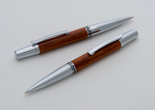

I also love these satin chrome Sierra Elegants. How does this satin chrome hold up? I really want to use them but the satin chrome part is right where your fingers go on the one that I like the best.
