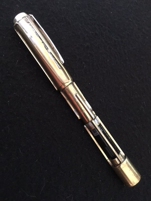

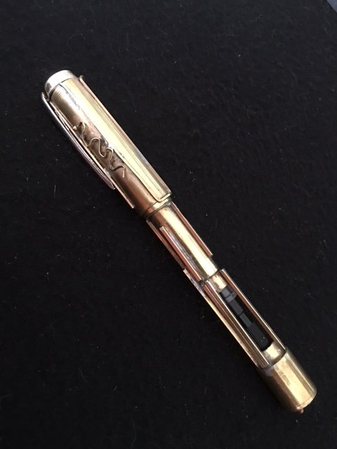

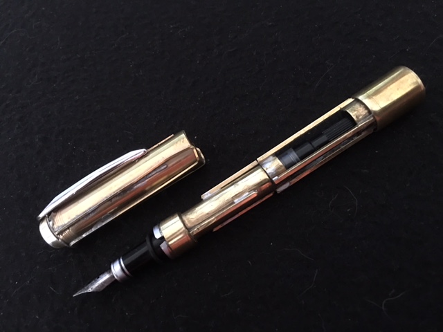

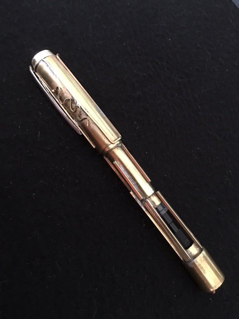

Bt, but, but ..... I cannot wait 'till night when sitting in my Mission Style chair, grabbing my sketch pad and my fountain pen and start sketching. My fountain pen has its place. It is not in my pocket. It floats between my desk and my easy chair. I love my Steampunk, all brass, custom made, hand crafted, kit-less fountain pen. If I ever get my hands on a metric tap and die set watch out !!!
The pen had been torn apart, sliced, diced, modified to the point that I could not offer it for sale. The I wrote with it and it was fantastic. so it is my keeper.
P.S.: To show it how much I appreciate thepen, tomorrow it gets a real heavy plated 24 kt gold finial, left over from another pen.
