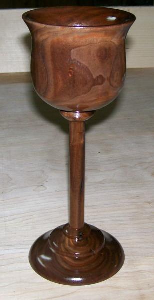

To any and all that have turned Goblets to be used, what type of finish have you used to seal the inside of one. I'm working with melting Plexiglass in Aceatone right now but it has turned out a milky color. I tried brushing it on a scrap piece of wood and some parts of the wood turned white while the rest was clear. I waited awhile and put a few drops of water on it and it works fine, and had no smell to it. I have read about the "Unaxol"and "Enduro" Any help on this as always would be greatly appreciated.
Thanks,
Jim
I think i may have already posted this but if so it was most likely in another forum, if so sorry for the double post.

Mylands sanding sealer for the outside, keep with the melted acrylic on the inside, or use a pour on epoxy finish. I did some faire mugs using the epoxy and it is holding up nicely to beer and abuse.
